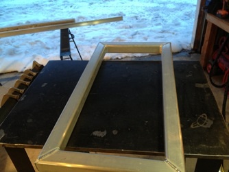

I have had a syncrowave 200 for many years and strpped up to an inverter.... First thing is to get it off the bench! This is stuff i had laying around the yard and shop.
Weldor
    Thu Feb 14, 2013 10:22 am
And more....
Weldor
And finished

Nice project you have going there Weldor. Hope you have a cherry picker to pull that beast off the bench. At ~240 pounds I can see why you want it off the bench! :o
    Sun Feb 17, 2013 1:30 pm
    Colorado
Guess I didn't wait long enough. You were posting and I was still typing...
Nicely done cart Weldor!

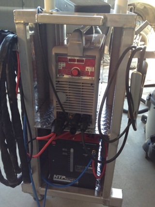

Weldor.
You might want to control the ventilation, if necessary, a slight modification in the area(s) of the venting slits.
Alexa
Weldor
Yea i was thinking of that... We'll see how it works out ducting it shouldn't be needed... But if it is, well, i am a jm sheet metal guy shouldn't be too hard

Lotsa room for air flow!

You using the floor and/or the hand control for the amps?
If hand, which model did you buy?
Alexa
Weldor
I am using the foot pedal... The one that comes with the HTP is similar if not a rebadged SSC Controls pedal. I used the SSC pedal on my syncrowave but sold it with the machine. Really good quality pedal. Not using a hand control at all.
Alexa,
I use a thumb-control on a synchrowave at work when the foot pedal is impractical. Mine is from Profax, an MFTC-14, for the 14-pin connector on the machine. I think the Profax part # is PX129-341.
It's quite reliable, but has a long travel like a volume-knob on a radio, so I tend to set my max Amps far higher than I need, so my intended range is within the first 1/3 of the dial.
CK Industries make one that has a "slide" action that I haven't tried, but I believe the slide action will feel more natural than working a small dial with your thumb.
