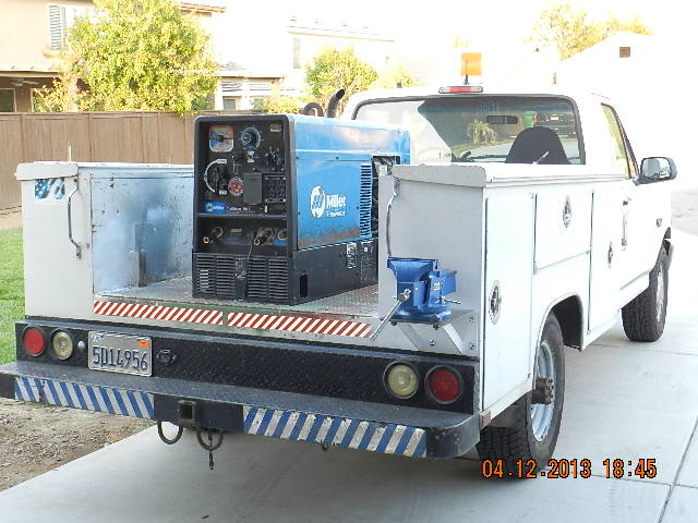

Here's a pic of the rig. That rear compartment has an Everlast PowerArc 160STH in it for TIGn jobs. Can run off the Miller Trailblazer or the customer's 120/240.
- DSCN4702.JPG (120.94 KiB) Viewed 3560 times
