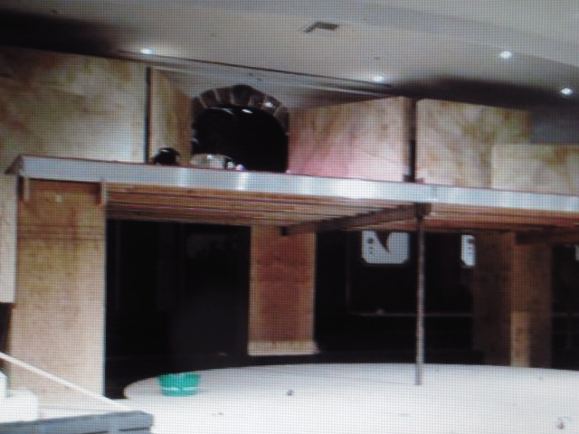

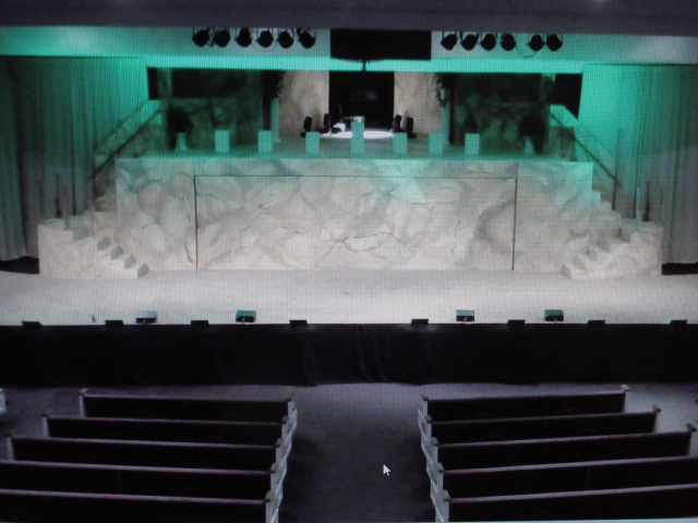

This was something I worked on before Christmas, a church show for the holidays. I don't know the name of the church or the show, but it was one of those shows that have the whole church and choir rockin' the entire time! I built the upper deck that held the choir. To get a sense of scale the entire upper deck is 32 feet across and 16 feet deep. It's supported in the middle by a piece of 6 inch aluminum I-beam and on the ends by some stud walls. I believe the deck is 8 feet 6 inches high to the bottom of the framing.
There are 8 deck pieces, each 16 foot long by 4 foot wide. Because the decks had to hold the weight of an entire choir, they had to be built strong. The outer framing is 9 inch by 1/4 inch aluminum 'C" channel cut at 45's and welded together. The inner joists on each deck were two pieces of 2 x 8 engineered plywood. 2 top pieces of 3/4 inch flameproof plywood were screwed down to the frame and joists. Once it was up in the air and resting where it was supposed to go, every deck was bolted together and then bolted down to the center I-beam. You can see a pipe sticking up out of the floor in the top picture, that works as the front support for the I-beam and also acts as a pivot point for the turntable floor just below the upper deck. The support pipe is a piece of 2 inch Schedule 40 steel pipe welded to a 1/2 inch plate bolted down to the church floor. The top U-channel piece that holds the I- beam in place are 3 pieces of 1/2 inch bar stock welded to the pipe. There are 2 holes drilled through the U channel and the i beam to hold it in place.
Each deck piece easily weighed 300+ pounds. Multiply that by 8 plus the weight of the choir and i was a little worried that just a 6 inch aluminum I-beam may flex too much, but i was proven wrong. The I-Beam, at maximum capacity, only flexed about a 1/4 inch.
The first picture shows the set under construction, the 2nd two show the finished product.
This is pretty typical of what I do welding wise, decks and trusses for shows. Tomorrow i start building some steel set carts for a new touring show about Marvin Gaye, the Motown singer that was shot to death by his father. Always something different!
