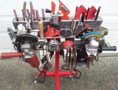

After seeing Jody's video review of SwagOffroad.com's tool organizer, I knew it was made for me. It's intended to bolt to a bench edge but, I wanted it to be mobile. Also, since we'll be moving to a smaller garage (with house attached), it needed to take minimal floor space when not needed.
The vertical support leans forward a bit to move the center of gravity forward to avoid tipping over backwards. It's surprisingly stable.
The front leg is hinged to fold up, has a magnet to keep it up and is locked in the down position with a pit pin. On the back is a 3-plug power cord and a large carabiner. When I'm not working on a project, the rack stores flat against the wall with the with the wheels locked, the leg folded up and the carabiner clipped to an eyebolt on the wall . Tools are still accessible, but out of the way. Holds a lot of stuff in a small space.
Total cost $90 ($60 shipped organizer, $30 steel & misc.).

Keep in mind that while I'm in the middle of a project, this rack sits empty- I've got all that stuff on the table.
At least I have a place to put everything when I'm done. Does your coffee cup always have bb's in like mine?
