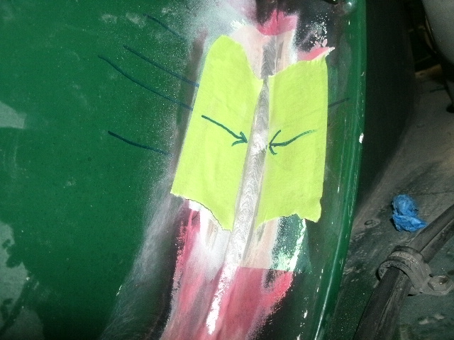

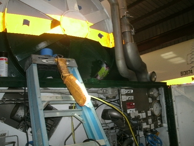

While I'm waiting on materials for my other repair, I began the leak investigation on another trailer.
Through tenting the entire trailer in a HUGE tarp, I proved the outer vessel was leaking, and narrowed it down to here:
or more specifically, here:
This is not the end of the search, however. This is just where helium can get through the MIG welds that attach this ring. The leak in the outer vessel may be several inches from this point (though not much farther, because the leak detector responds almost immediately).

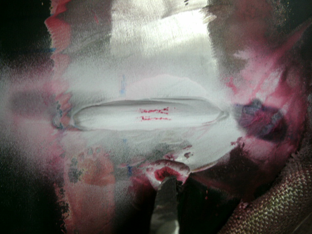

Okay, I put my finger on the leak. I sectioned out 4" of the ring, cleaned it up, and hit it with dye-penetrant. I found this crack, with spider-webbing at the ends, an inch and a half from my starting point. Like hitting the lottery, on a Monday morning!
After grinding edge-on with a 1/4" wheel 'til about 2/3 through the material, I hit it with the dye again, and found this:
The space between the (now) two cracks is about 1/4". As I finally ground through, I shot it again (I'll look at the result in the morning). If I've ground out the entire cracked area, I'll TIG it up open-root. If I have to grind more out, I'll open it up enough to get a small backing-bar in it.
Isolating this leak and retesting the rest of the area showed this to be the only leak, so it was a great Monday!

Do you get time parameters for the repairs or is it "it's done when it's done" ?
Steve,
When you have time could you give your opinion as to what particular flaws were in the original work, noting what prevented this nuisance leak from becoming a catastrophic failure (say a burst which would require an emergency response as a tanker driver or yard manager) since you are obviously up close and personal with the "patient" !
Thanks,
Shawn
Thanks,
Shawn
Shawn,
This is, in part, speculative.
I don't believe there were flaws in the workmanship. The origin may have been as simple as a tiny inclusion in the plate this vessel head was made from. I saw a YouTube video of the manufacturing process. These heads are cold-formed, and in the video I saw, done in a huge CNC hammer mill, though the uniformity I see suggests something more like a huge English Wheel, or perhaps a drop-forging process. Regardless, the new stresses around an existing (if microsopic) flaw provide the starting point.
The MIG (or possibly FCAW; both were used at different times) welds of the "wagon wheel" structure added another distortion component.
The final straw is the purpose of the wagon wheel. The center (hub?) is connected to the inner vessel, and is the only thing that absorbs front to back movement of the inner vessel and it's contents. The cargo at full load weighs about 7400#, and I'd estimate the vessel at 10000#, so the wagon wheel is absorbing the inertia of almost nine tons when the truck accelerates or brakes.
The main reason this doesn't lead to catastophic failure is the extreme over-engineering required to permit rocket fuel on the highway. The load is spread over such an area that it's like trying to break a paper clip by bending it a degree or two, slowly, for thirty years. Even the paint helped protect it. The vacuum loss increased 10-fold after I wire-wheeled the paint off the leak area. Also consider that the space between the inner and outer vessel is under vacuum, so the air we breath is pressing in on this rounded surface at approx. 14.7 PSI. (For a 10" X 10" area, that's amost 3/4 ton mashing the crack shut!)

That's wicked. That small amount of metal is probably more expensive than it's weight in gold by now. What would be the full benefit of a backer in such a situation in the event you had to use one? Admittedly, only time I ever used them was for certain open root joints in school but then we washed the backers off with the torch afterwards, leaving the root.
I did end up using a backer, and in this application, it's permanent. By the time I'd removed all signs of cracking, I had an open root slightly more than 3/8" at it's widest. Certainly doable, but at that size, it's big enough to get a thin (14 ga.) backing strip slightly larger than the root in there.
Often, backing bars are required because the insulation (200 layers of mylar/tissue wrap) is so close to the weld zone, it needs protection from direct welding heat. This was not the case on this rear head; The space for piping and the longitudinal support structure means nothing was within the heat zone.
I welded half a SS lock-washer to a 1/2 X 2" strip of 14 ga, tied it with safety wire, and fished it in the hole. Pulled it tight, levered the wire over some 3" angle, and weighted it with a 3" 150# blind. Centered it with needle-nose pliers, tacked it in, then broke off the washer, and ready to weld.
