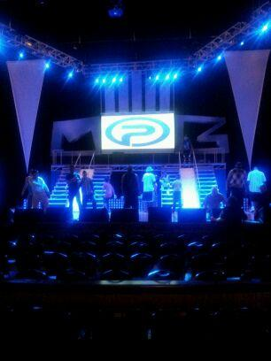

Here's a few more pictures......
#1....The stringer pieces joined together with more square tube. Besides strenghtening the entire structure,these connectors also give the roadies something to grab onto to carry the units. The wood piece is a temporary stretcher until some x pieces go in the middle of each unit.
#2....Almost finished. The step treads are aluminum bleacher seats that are tek screwed to the square tube tread supports. The next step is the removable railings. I took a picture of the steps with the railings on them, but for some reason i can't get the picture small enough to post. The railings were all interchangable to any step unit and fit into three tube holders that had a bottom stop welded on them. The tubes and railings were all drilled through and secured with a scaffolding type drop pin. The original plan called for all aluminum railing, but budgets can get cut quite a bit in this business so i wound up making them out of thinwall galvanized fence tube. That really sucked, but they come out pretty good. All the railing joints were saddle cut for a nice fit up.
#3.....The finished product onstage!
