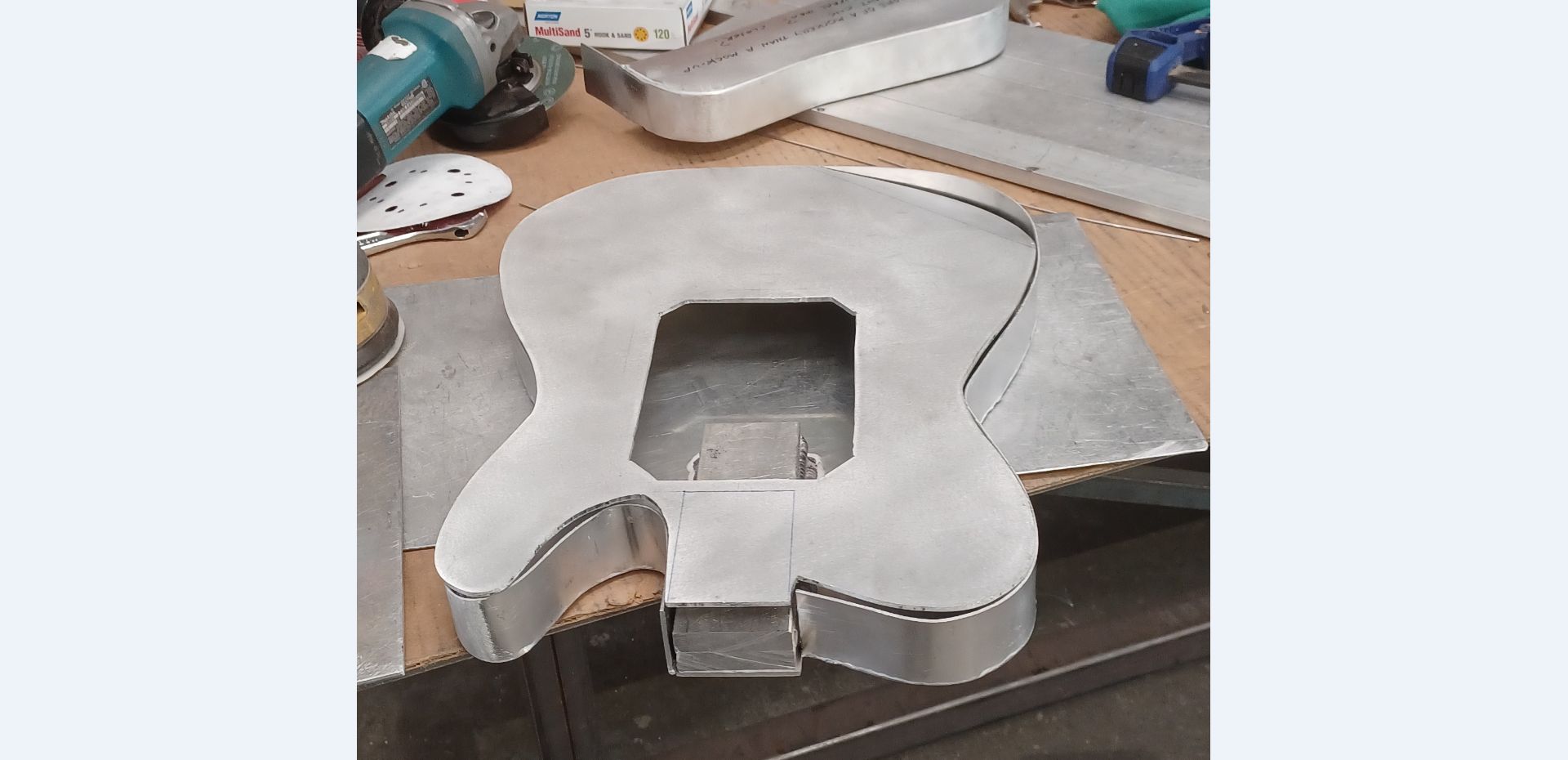

At work, sometimes I'm busy and sometimes I'm not. Sometimes I make things out of scrap metal that the company doesn't ask me to make. They know about this and they don't discourage it -- it's great practice and they know I always come through for them at all critical times. I traced a Telecaster body onto cardboard at home and brought it to work. Material, all of which had been destined for the scrap bin: 1/8" aluminum mill plate for the top and bottom.
- 1.jpg (121.57 KiB) Viewed 56709 times

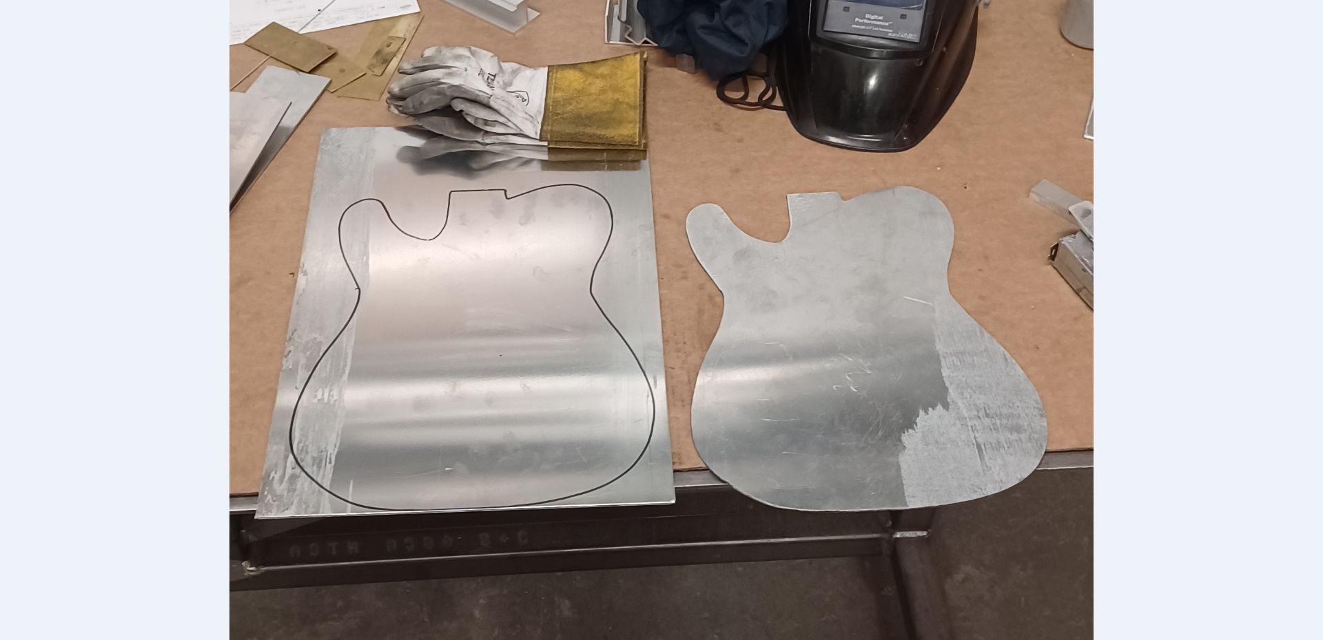

I'm pretty handy with a band saw.
- 2.jpg (155.5 KiB) Viewed 56708 times

The sides were 1/16" thk aluminum. This was mostly fusion welding without wire except for when needed to fill small gaps.
No purging and no way to use chill plates due to the shape.
It's good to experiment and get seat time on something like this, but to be realistic: fusion welding alu usually doesn't work too great as the welds tend to be very weak and crack quickly without any filler.
For steel and stainless it's a good option if your fitup is tight. On alu it's never going to be great. Basically the bigger growth and shrinkage on alu under heat combined with the weld contamination of the oxides floating in there makes for a weld that gets under very high stress when cooled and has impurities that form points for cracks.
That's whay you do see people tacking alu, but again these are much weaker than steel tacks, but use filler on the full welds.

1/8" aluminum mill plate and a couple of pieces of 1/2" to support the neck.
- 1300.jpg (94.14 KiB) Viewed 56347 times

Joined:Thu Sep 19, 2024 8:13 am
Fusing .080 aluminum to 1/8" mill plate without backing or purging is a tricky business.
- 6.jpg (148.21 KiB) Viewed 56338 times
