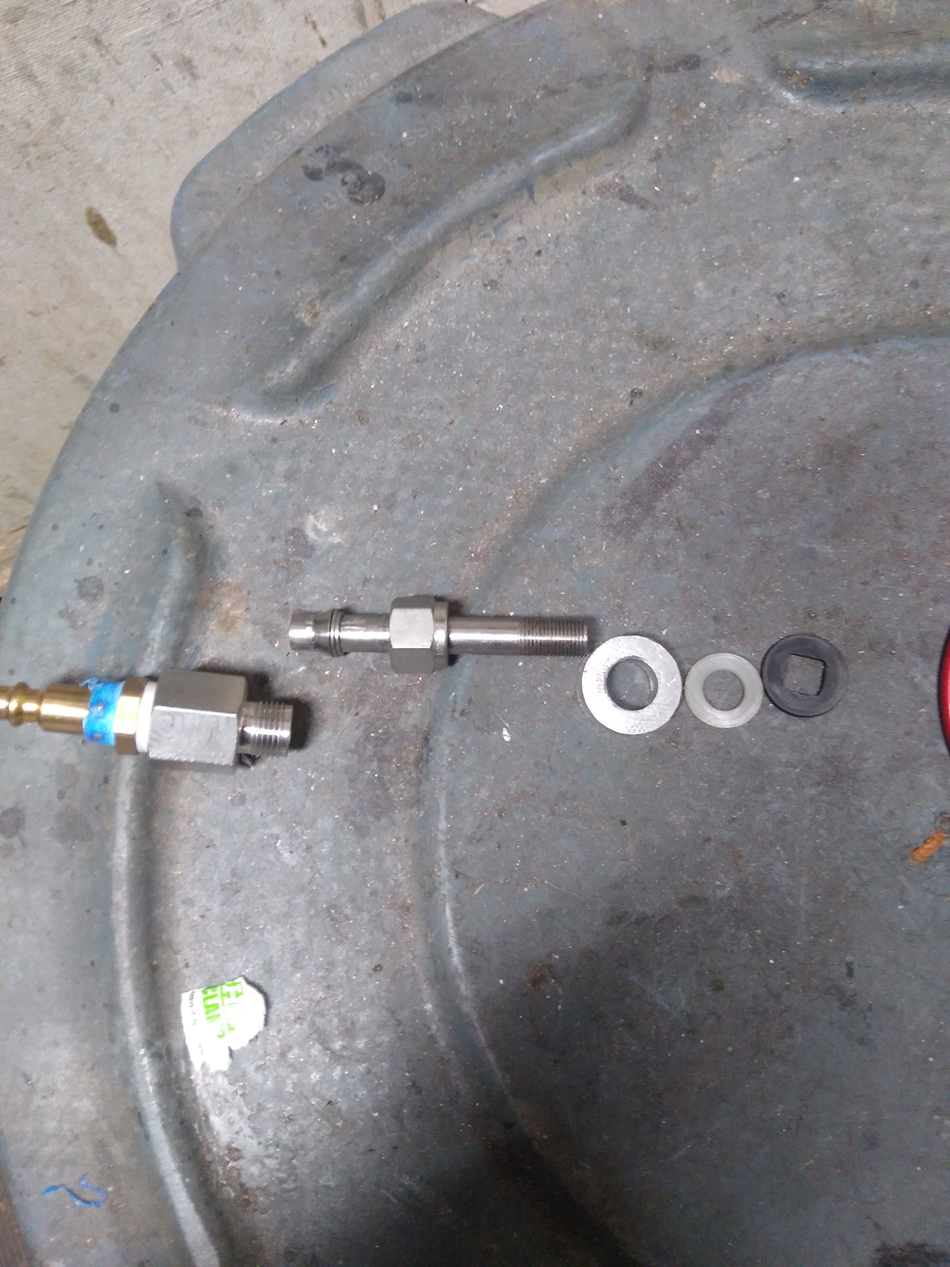

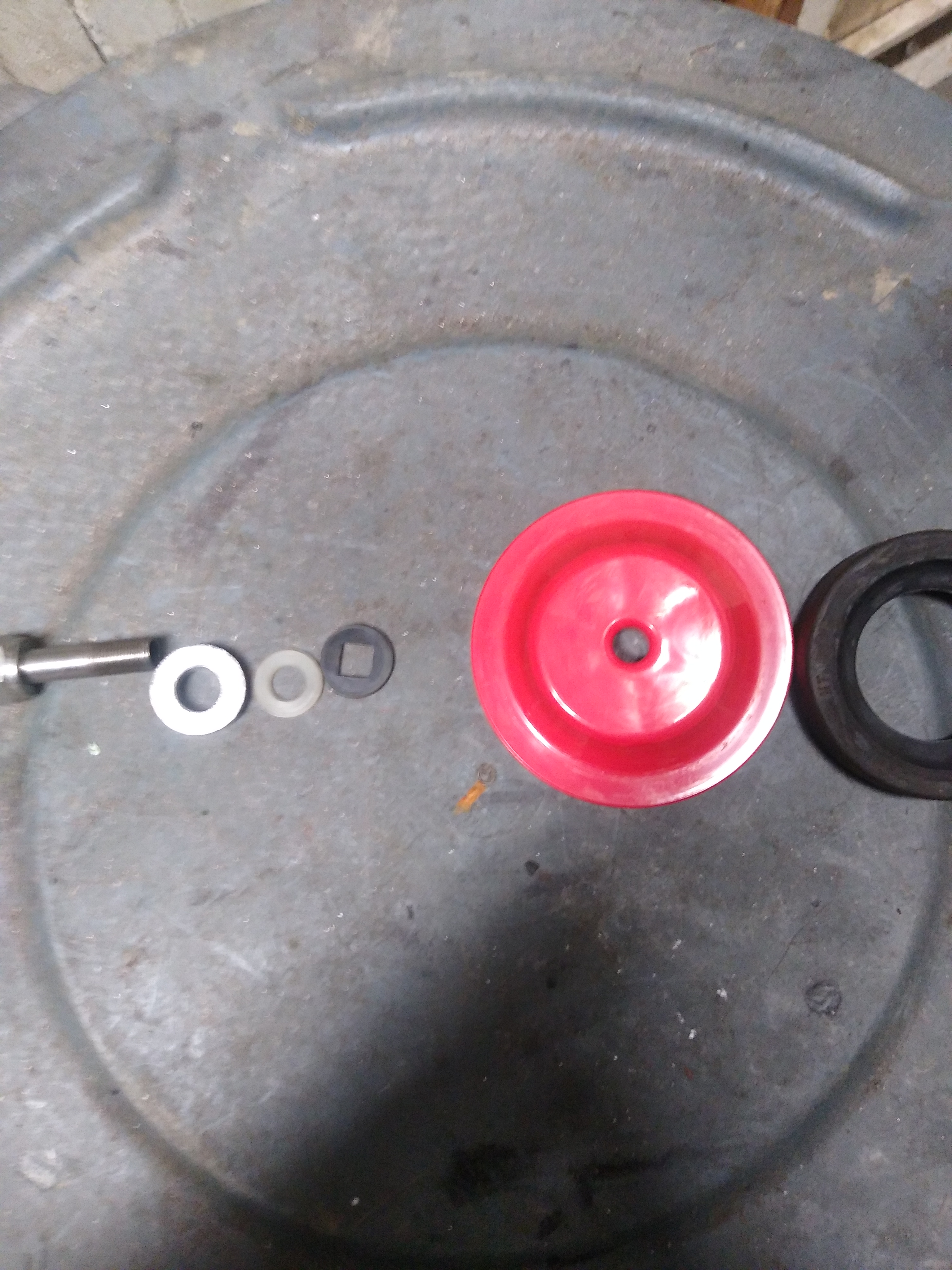

I thought I would share my homemade purge plugs, they aren't expensive or hard to make and they seem to work great. What I did was I bought the drain plugs from home depot, jb weld steel stick, air compressor baffle bolts(if that's what they are called I can't remember), some 1/4 inch stainless instrument tubing, 1/4 stainless compression fitting to 1/4 npt fitting, one 1/4 or 5/16 coupler but I can't remember what size I used, and quick connect air hose fittings. I don't know if they are really needed but when I was learning to tig stainless I was told when you are purging the pipe you don't want gas just pouring out that's why I used the baffle bolts or whatever they are called. And I threaded the stainless tubing to match the threads on the coupler nuts I used on one side then a stainless compression fitting on the other. Just remove the bolt and wingnut from the plug keep the seals though then you will jb weld the coupler but to the bottom piece of the plug take your compression fitting with the tube that has been threaded for the nut reinstall the seals onto the top of the plug in between it and the compression nut then just thread it together and install the baffle on the coupler but and voila you have a adjustable purge plugs that seals perfect. You could always do something different to them I just made them like that cause it's what I had in my scrap bin. And when you are installing them to a pipe or tube just hand tighten them to close to the same size Id then put it in and hand tighten them from the fitting on the top the gasket will grab and keep the bottom from spinning then I just snug them up with a wrench and ready to go. If anyone needs any help making them just message me, but I will put all the pictures of them disassembled but it should be no problem once you see them

they are compressed air exhaust mufflers.
one thing to watch is that the plug can handle the heat. usually not to bad on the longer bits, but doing short bits you can cook the plugs.

Ya I doubt they can handle the heat of something like pie cuts but I've done a few 2 inch and 1 3/4 inch 90° without any issue but I also do the welds in sections and let them cool down all the way before I start the weld again. I would like to make some really nice ones that are more heat resistant I just like how thes are adjustable so I don't have to have every size known to man lol.
