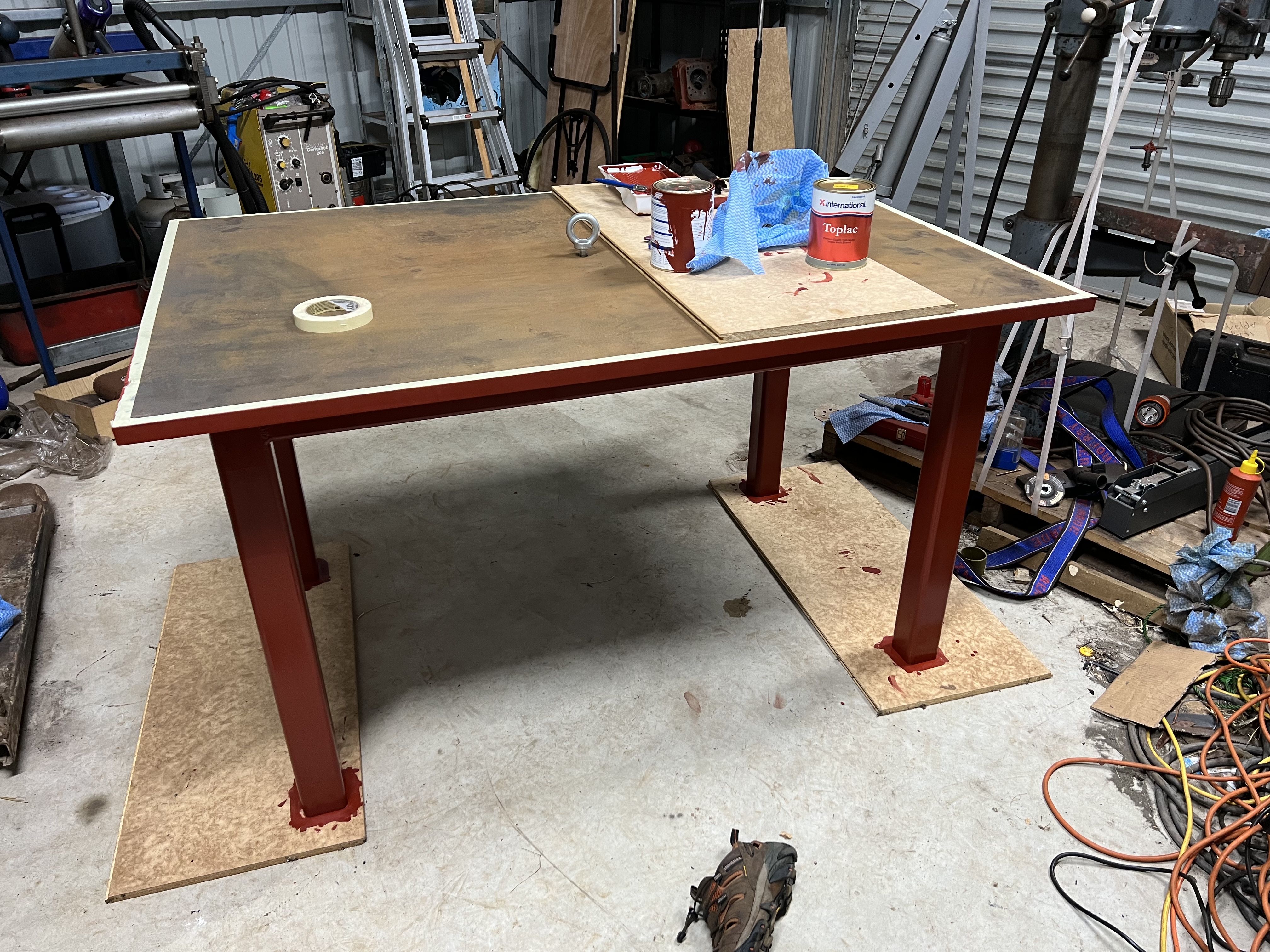

At the painting stage now. I’m using PA10 Red oxide primer. Have only put one coat on so far.
Finish coat with be a marine enamel paint made by international in Atlantic Grey.

Coat 2 primer done. Primer left over so will see how it looks before I put finish coats on.

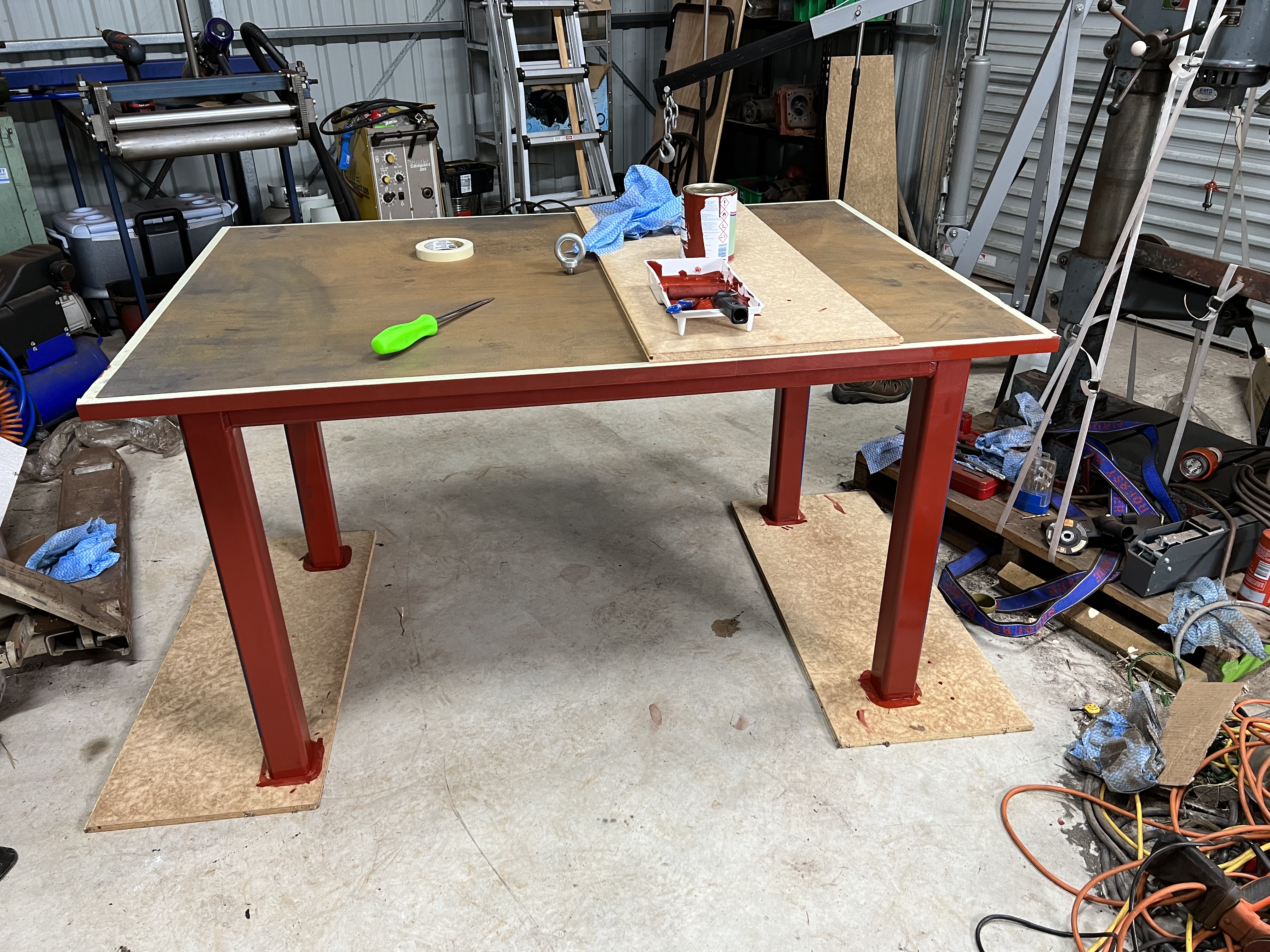

First finish coat done

I put a thread for an eye bolt in the centre of the top and will move it with an engine crane but it will only be moved from where I’m painting to where it will stay permanently or at least where it will live for now.
I have no reason to move this table once it’s finished.

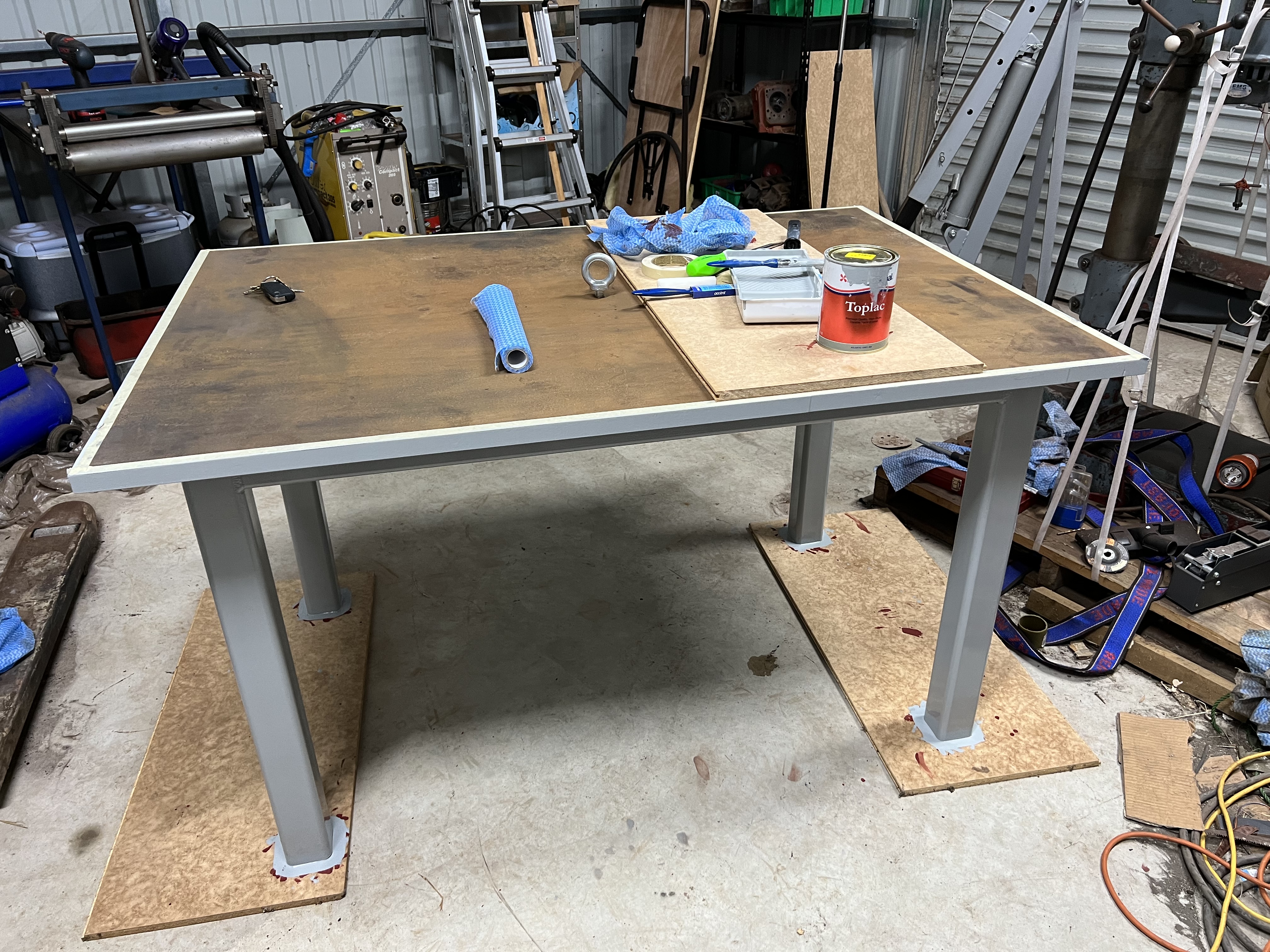

It might serve you well to add leveling feet to it. I’ve yet to see a shop floor that was flat and level unless it had a metal surface plate shot in.
If you ever start punching holes in the top for clamps, you will want added stringers across the width of that table to prevent any sag. Solely having a perimeter frame will let the center droop, and if you drill 5/8” holes it will reduce the strength sufficiently that your top will not remain “flat”.

Yeah there are a few future mods I might do.cj737 wrote: ↑Wed May 18, 2022 7:10 am It might serve you well to add leveling feet to it. I’ve yet to see a shop floor that was flat and level unless it had a metal surface plate shot in.
Just an FYI-

Second coat. If I’m happy with it I’ll leave at 2 coats. If not a third will go on.
