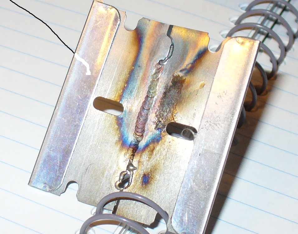

Ok ok show off. What amperage did you have your machine at? I want to try that at work to show off. Would be a hoot for the guys to see that. I would walk upto them and say "Try shaving with this!"

Hi, I don't remember I was trying different settings getting use to this machine, it was on low 20 amp was the max I believe, I was using .040 2% thor tung. you can do it watch the arc length it likes it super tight to the work. have fun.
