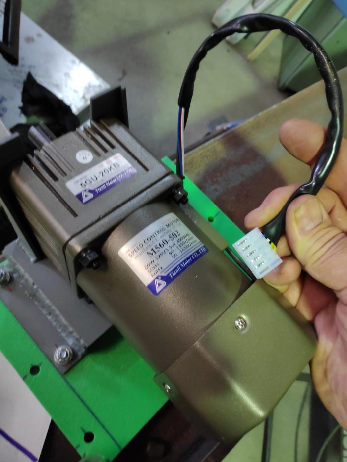

Been slowly accumulating bargain price parts for a positioner that I’ve always wanted but don’t really need. 4” 3-jaw chuck and rotary table from India. Motor and speed control from chinesium, local pulleys and machining. Time has come to put it all together in a box the can be vertical or horizontal. Haven’t thought about a plan yet.
Any suggestions would be helpful please.

The speed control turns down to stop, gears and pulleys gives max 6rpm. I was going mount the motor on an pe chopping board scrounged from home to isolate it. The speed control is panel mount plastic housing so that’s good too. Purge would be nice but the base is not really suitable I don’t think. I’ll take some pics when I’m at the shop next.

Have a question for electric gurus out there please. See the pics of the electricals, and remembering that here in oz, we have 240V 50Hz single phase power (240V active plus neutral plus earth).
1. On the speed controller, I'm guessing the blue bridge wire to terminals CCW-COM can be used for a remote start switch. Is this correct?
2. It seems to me that this controller will only turn the motor in one direction. Can you see a way to fit a reversing switch?

By the way I sorted the electrical issue after suitable application of beer the other night. Simple solution of a two position switch if you don't let the Chinese writing confuse you and realise a square box on the diagram is actually a capacitor. All fell into place after that.
