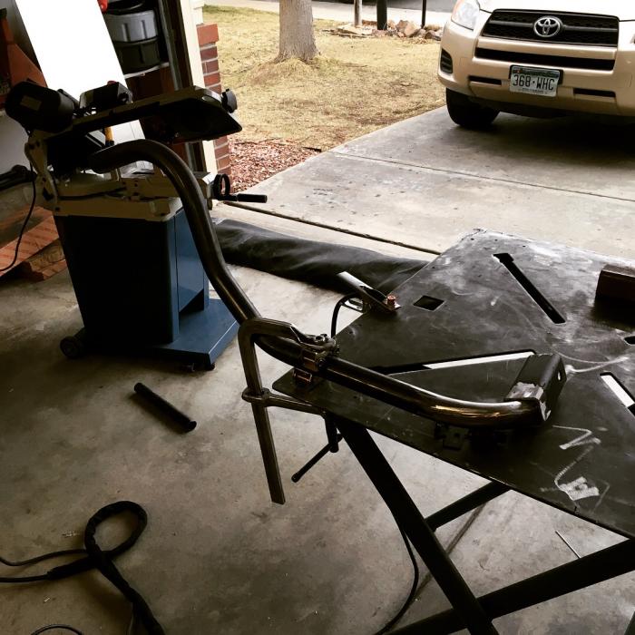

Not really a necessary thing but I’m trying to practice TIG every chance I get. I’m also happier having the tank outside the car because once you can smell it up front, there is already a decent amount inside and I’m not too partial to blowing up.

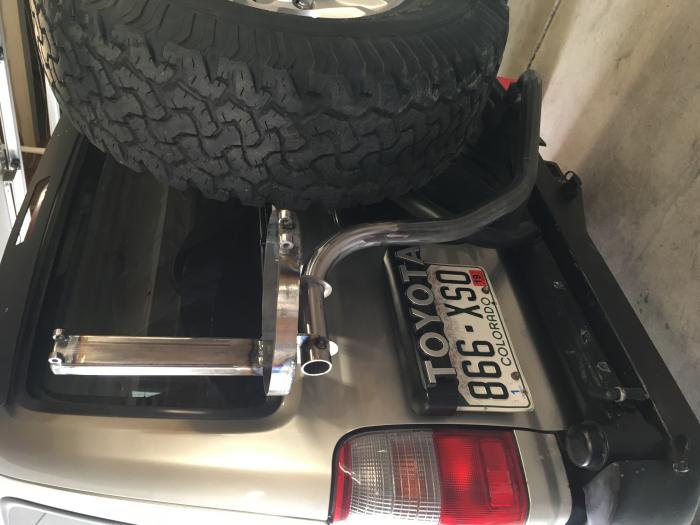

I built the rear bumper and tire carrier about 5 years ago and stuck a second 2” receiver in the swinging arm so I could carry a bike rack or whatever and have it swing outward with the tire so it was a bit more convenient.

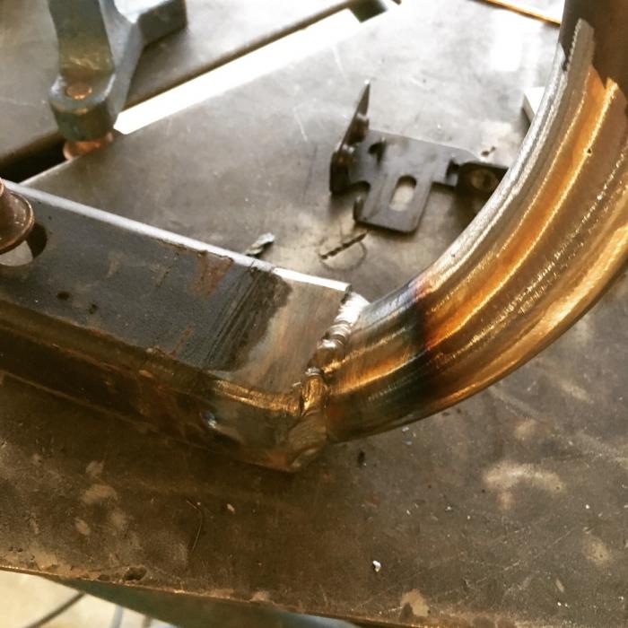

I started out bending up some 1.5” .120 Wall HREW tubing.

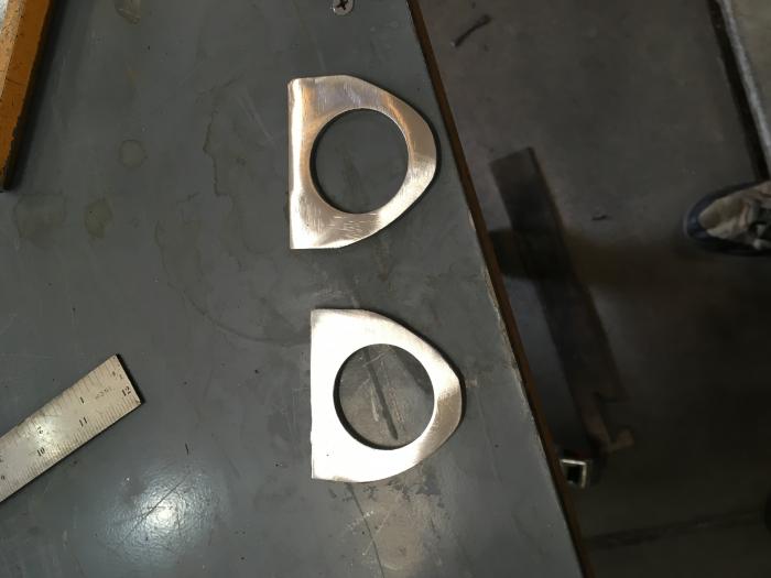

I cut the receiver off of an old busted bike rack and crudely “fixtured” it.

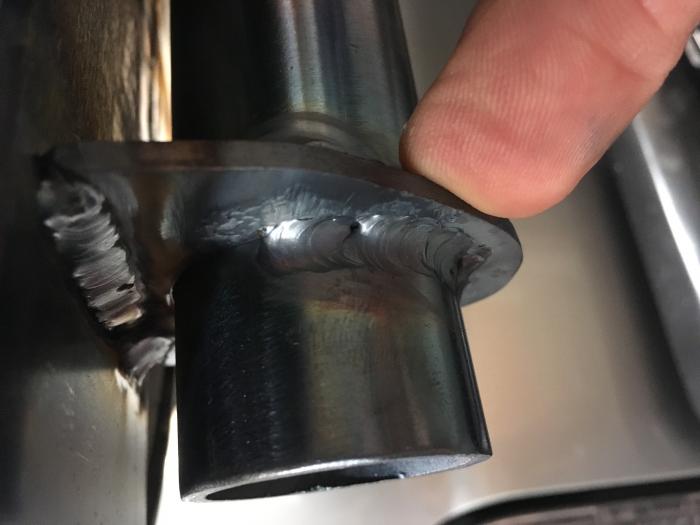

I had to fill a bit and ended up really heating the piece up. Kinda greeted out I think from being so hot but outside the Ar. Could just be bad technique as well.
Tested the fit and shape

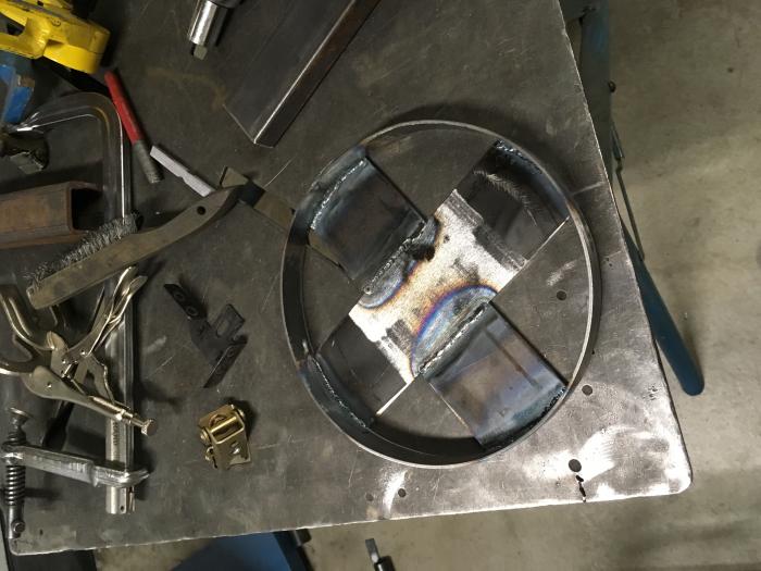

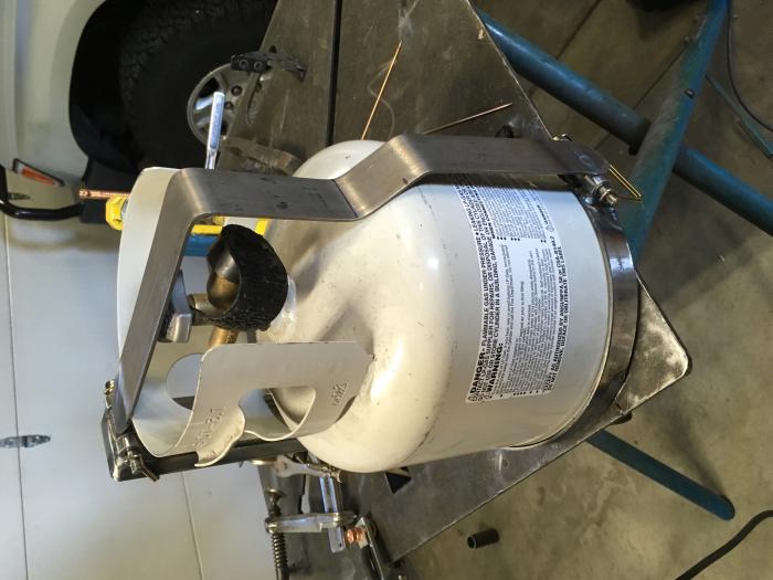

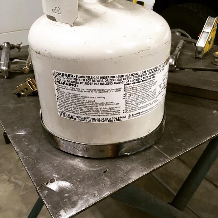

I then shaped a piece of strap around the tank using clamps and hammers and my hands. Took a long time but got it bent and then welded it up. It fits the tank perfectly (surprised me actually, generally things don’t come out that well)

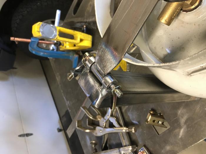

Then I made the restraining strap. Used a swag off-road press brake.

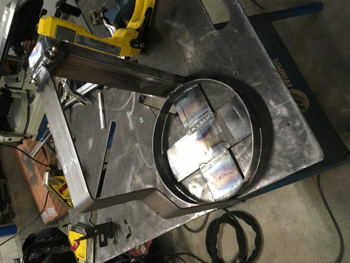

Then I tacked made two brackets using some scrap plate and tacked it up
Welded it up once I was happy with the fit.
I gave my first go at walking the cup. It didn’t go well. I also tried a long stickput with a #8 Gas lens for the hard to reach parts. Too much torch angle I think and lots of brown.
That’s where I’m at. It is just a bit too wobbly bolted into the hitch. Gotta work on that. And still need to cap the end of the tube as well as add a bit of a gusset on the inside. But happy with it so far.

Sorry, not sure why some of the pics are sideways.

You can add some welded “beads” on two adjacent sides of your plug-in to the hitch receiver. That will improve the fit and allow you to get a snug, no wiggle ride for your appendage.
