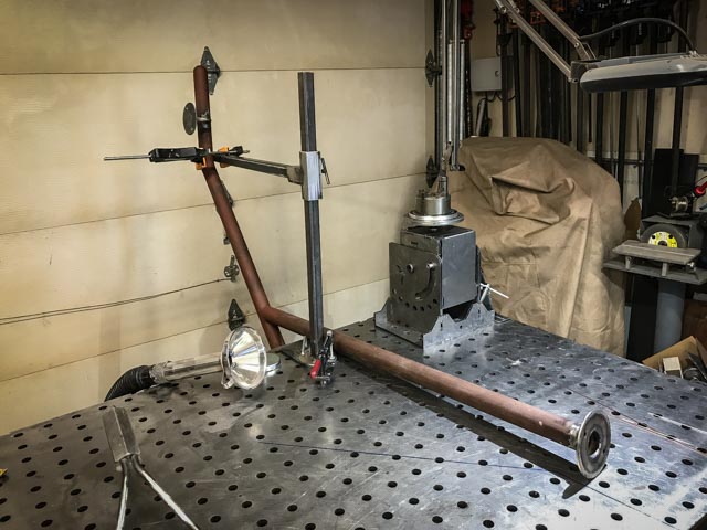

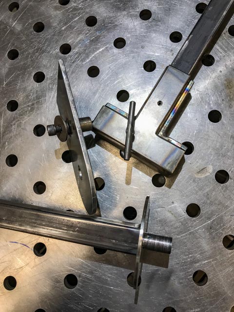

Built a steady-rest that can be placed anywhere on a Certiflat table, rotates in 360 degrees and can reach heights of 24" off of the table. It reaches out 20" for those long welds.
Now, I can keep that proper distance without dipping the tungsten.

- Apart, you can see how it fits the Certiflat table.
- Steady parts.jpg (114.98 KiB) Viewed 4352 times
- Rather that tacking on nuts, 1/4" plates, tapped holes where used, to adjust the arm. The stainless round plate is used to keep the upright plumb and a place to lock the rotation.
- Steady close.jpg (97.22 KiB) Viewed 4352 times

- Here I'm tacking a tall roller.
- Using steady.jpg (101.99 KiB) Viewed 4352 times

A prop is a nice tool to have, BUT, you also need to learn to weld with your cup resting or walking against the material. There will be times (round, circular, tubular) when material shape requires out of position welding and you need the skill.
I like a rest for straight, tall pieces when I can't lay my wrist or forearm on my table. But I find that it promotes "air welding" (cup not in contact with material) and I do try to avoid that as much as I can. As long as you position your rig in tight and keep honing your skills, any tool is a good tool in my book. And yours looks nicely executed

- tungstendipper
Thanks for your coaching. I rarely rest my cup on the work. Sounds like I should. I still practice weekly. This week I'm going to work on narrowing my beads and edge welding on 1/8" plate. Using Bob Moffat's recent video as a challenge.cj737 wrote:A prop is a nice tool to have, BUT, you also need to learn to weld with your cup resting or walking against the material. There will be times (round, circular, tubular) when material shape requires out of position welding and you need the skill.
I have a hard time sliding my hand, during a weld, on a table full of holes. I still haven't use my pulse settings because I want to learn the basics without any help. Would rather develop the use of my foot pedal for more heat control.

Getting your arm/hand to slide is probably due to too much tension in your hand on your torch. Its easy to say, but difficult to do, but you need to relax your entire arm, shoulder, and wrist. Stop gripping that thing likes its your best friend
Hold it like you would if it were the hand of your newborn child; delicate, and under control. And rehearse moving your arm and torch before you strike up. This helps you notice the tension in your body.

BTW... The Extractor inlet (which I'm embarrassed for anyone to see the welds) seen in the pics, is made up of a stainless, light gauge, kitchen funnel "tacked" on a 1/8" thick stainless tube to fit the hose. It attaches to the weld table via a 3 dollar Harbor Freight magnet and a lamp goose neck. All of the above, is connected to a Lincoln fume extractor.
