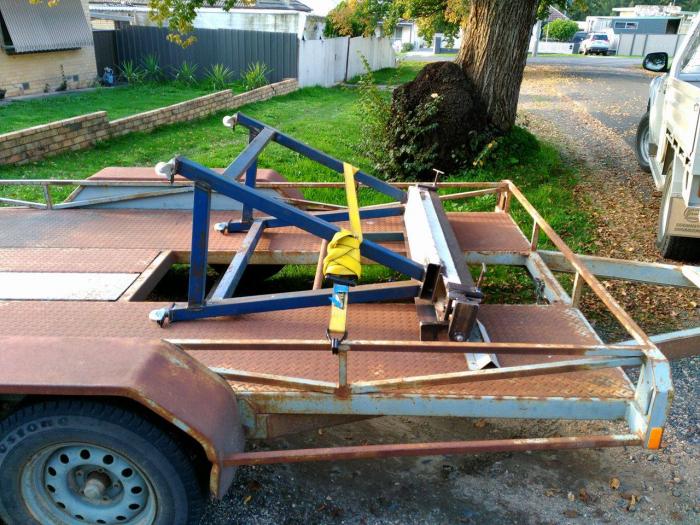

Stand is 50x50x1.6 rhs(box) with a bit of 150x50 along the top. Don't zoom in on the welds, all stick welded with a little tig.

It's for a mate, he's building an MG-B racecar. He had money and no time, I had time and no money.

If anyone is wondering about the small welds that don't tie completely off, the need to not distort the set up was king here. Small welds will work because its not under a huge amount of stress. This was hard for me to get my head around because I am used to doing 8mm fillets with a mig set to nuclear.

It was designed that if you went nmuclear on it, it woud go to shit. Tjhat is all. Plus he's a mechanic, NDT operatror and all around general tinkerer, so he knows.
Coldie...Heres how it breaks down, I wish i had gone straight to the new steel option, I spent far too much time looking for second hand.
*3 metres of angle (third of a length) from Surdex $110, I had to push a little to get these answers as a couple of guys said they wont sell part lengths. But it is a standard stocked size.
* 1400mm 125x65 mm channel, bought from a local engineering joint, $40 bucks
* Odd pieces of flat bar, scrap from around**
* 150x50 rhs and the parts from my friendly local second hand man, mates rates $20 bucks.
*RHS for the a frame, customer had that already.
Bolts and bits, from my collection of bibs and bobs.

The metal thickness is changed by the two T screws on the back edge, they are supposed to have a circlip on them but I didnt deem it apppropriate for this particular job (read: it didnt work) so we are going to drill and split pin them. They have a machined shoulder which pushes on the angle for moving forward and the pin drags it back,
Plans are here:
