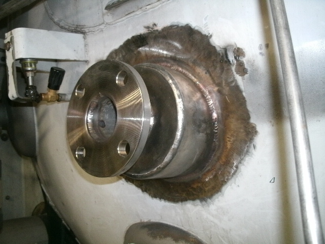

Here's the way I spent my Friday:
Everything without paint on it is new. The six-inch sch. 40 is not "let in", it had to be coped to the rear head so I had to scribe a compound curve, fit and weld an end cap that centered on the 2" pipe, then fit and weld the flange (which the boss insisted I "stovepipe", meaning I had to install the spool that goes there, then tack the flange.) I landed within 1/16" of my layout.
I had to stand on my head for some of this, here's where it's located.
The original bell-cap that was in this location was leaking; It had cracked at (and through) the pipe, allowing air and liquid oxygen into the evacuated space.
- GEDC0747.JPG (219.42 KiB) Viewed 1644 times
