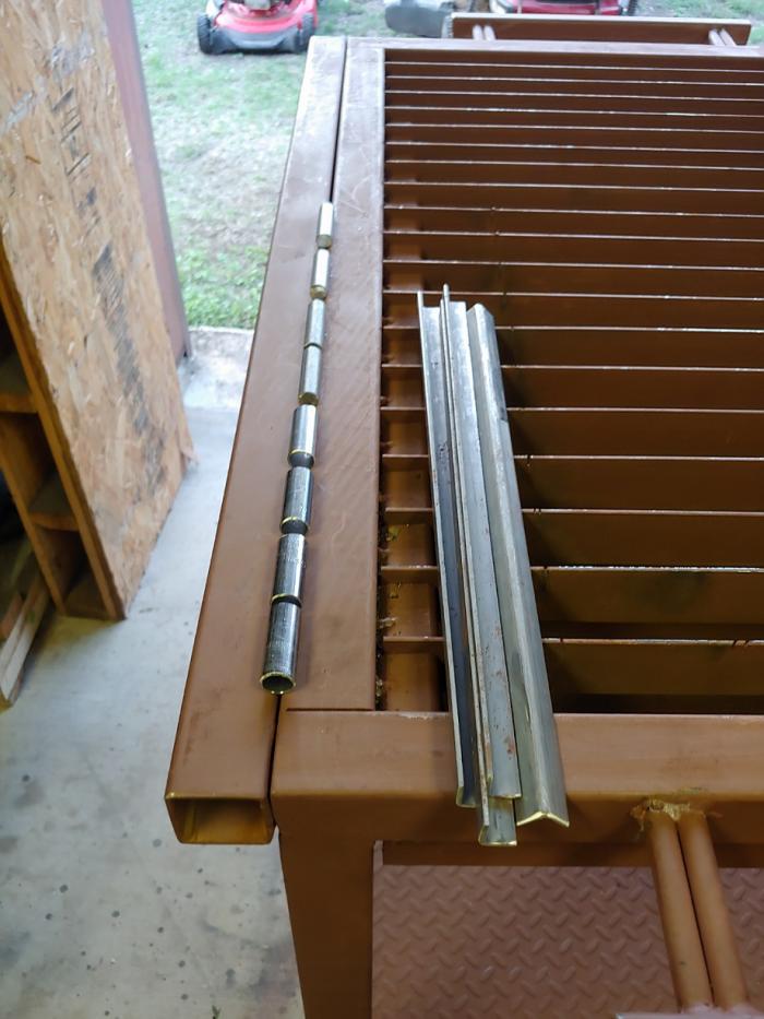

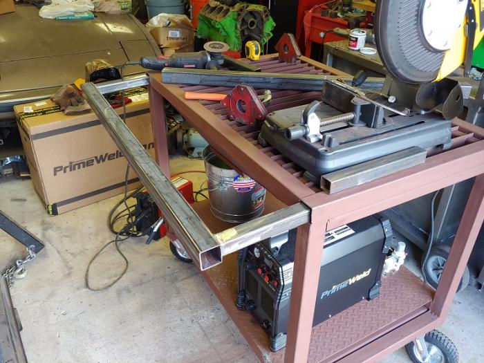

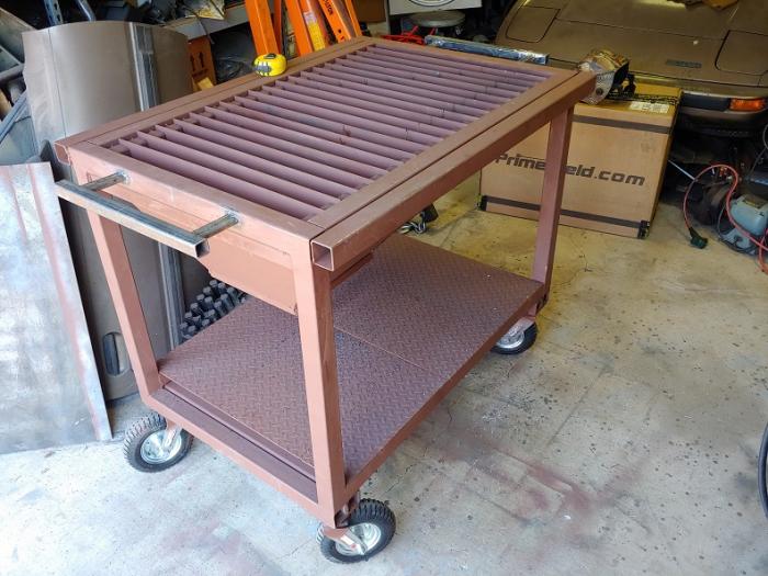

Well it was both an intriguing and somewhat productive day in the workshop today, so I can't complain whatsoever. Mama (my wife-eee) wanted to work on her outdoor rocking chair and so I had watch-the-lil-un duties for most of the afternoon and evening. Can't complain about that however, since the time when mom-n-dad aren't cool anymore will come 'round all too soon. Thus having my son in the workshop with me is a treasure I'll not refuse. Projects can wait dontchaknow.
That said, I decided that with the little time I had available I would tackle the expansion/extension element. That seemed like a reasonable task to polish off given the time limitation. In the end I fabricated them but needed to postpone the leveling mechanism until later on. 'Just not enough time today. No worries. But I'm getting ahead of myself. So. The expansion/extension material cut to length:
I placed the longitudinal members along the sides and the inserts into the end framing:
Taking care to get the extension tubing level with the tubing of the table, naturally. Thus the reason for the small bits of tubing resting on the top of the table in the second picture.

After a little grinding with the flap disc in order to minimize the distance that the weld bead will cause the extension's longitudinal member to separate from the table when in the fully closed position, that's one side done:
And in no time I had the other side matching the first:
- extensions 3.jpg (73.74 KiB) Viewed 8472 times
- extensions 4.jpg (215.56 KiB) Viewed 8472 times

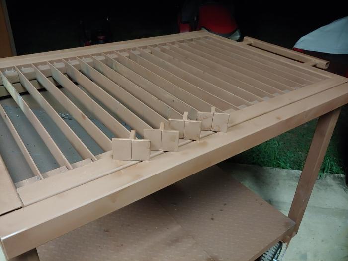

Removed them so that I could apply rusty metal primer:
Then re-installed them when that was pseudo-dry.
I opted for lateral extensions on this project rather than ones on the ends. For my use case scenarios I will likely need the width that this choice yields over the length of the opposite selection. So this was a design decision from the outset, but I didn't have it in the drawings. It's also the reason that I fabbed the frame ends the way I did. Ordinarily I would have taken a different path during the table's foundation portion of the overall build. However in order to have these lateral extensions I would need to fab the table ends in the manner that I did. 'Design choice. FWIW.
- extensions 5.jpg (71.77 KiB) Viewed 8472 times

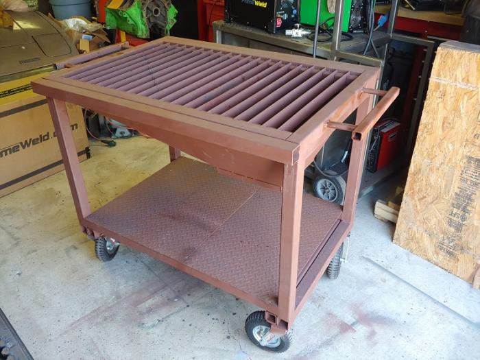

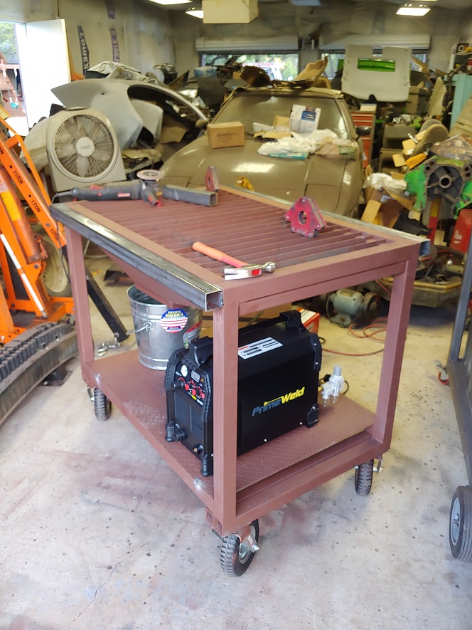

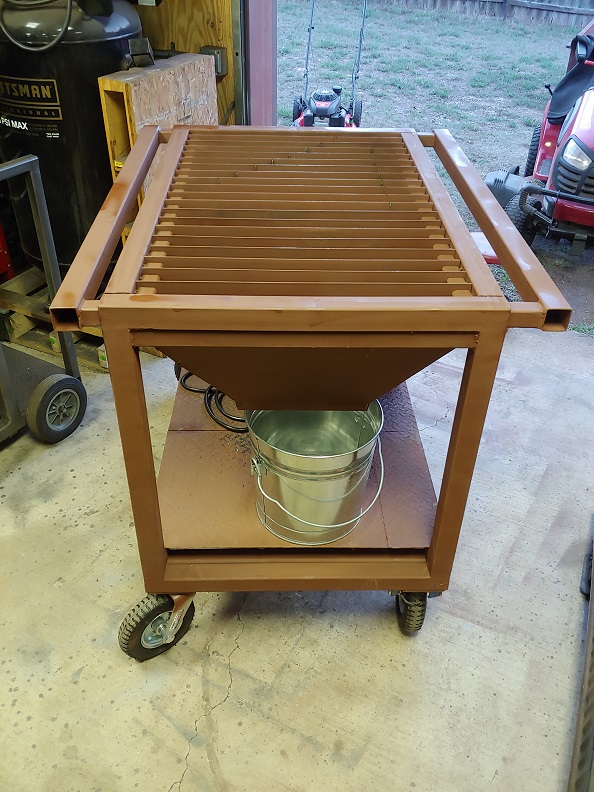

All too soon it was time to pack up for the night so that I could get inside and help the wife with the lil' un. So I pushed the extensions in, removed the CUT60 and wheeled it outside. Prior to doing that I took this picture:
And this one to show the idea of the design:
When possible, the CUT60 will live on the shelf of the table, as will whatever drying apparatus I end up with (which reminds me to take a look online for a desiccant dryer as Oscar mentioned). When the table can live indoors permanently I'll update the casters and perhaps create a small bin to hold consumables, etc.
However lots of little things still need-doin' on this build. I need a handle, hose coiling/hanging bracketry, etc. I did decide to tack the lower shelf in 5 places today rather than leave them free-form. That was because my son attempted to climb on the top of it and one of those panels moved slightly when he did. That didn't affect his mount, mind you. He was on top of it in nothing flat dontchaknow. However as a dad, I eye-balled that panel and privately told it "...that's it, you're getting locked down and immediately so."

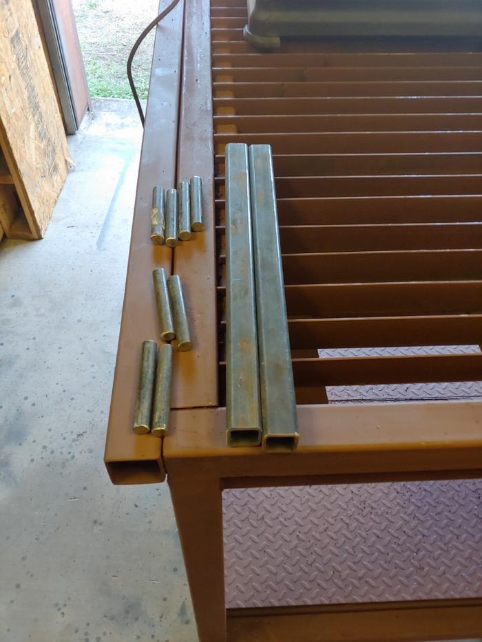

Still outside working, so I'll have to keep this short. Need to mow the lawn in a bit. So I finished the plasma table this afternoon. Well about 95% of it anyway. I still need to install a couple of hooks to store the torch cable onto. Save that I'm done.
The primary elements that needed fixing were the extensions. With the 2x2 outer tube and the 1.5x1.5 inner tube there was a significant droop that I didn't want to live with:
So I cut some angle iron, round stock, tubing and all thread:
