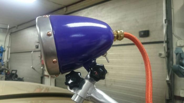

Had an idea for a work light I had to get out of my head.
Made it from aluminum and steel. It has a 5,5W LED light in it and is fully adjustable in all directions
Some welding content
The steel parts are 0,9 mm thick, thinner at the rear dome after all hammering.
Welded with minimum of filler and then planished.

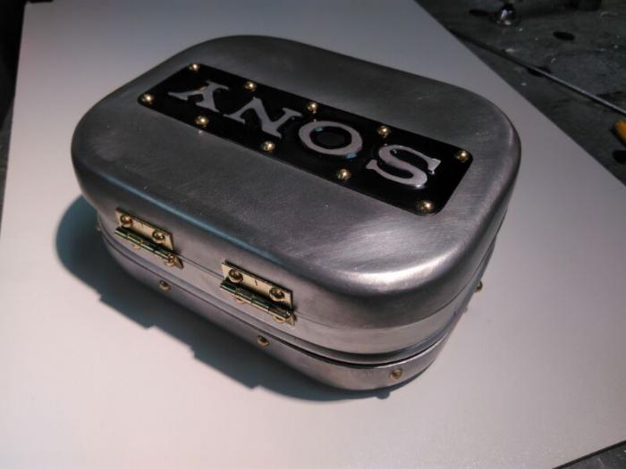

This box is awesome. I tried metal spinning on my lathe to make an 18" Venturi and it was a disaster.AndersK wrote:Not any welding here, just wanted to show a box I made for my gas torches.
Made in 1,5mm aluminum with stainless handle and hatch.
Once again, I could by a cheap box but what do one learn from that?
I could have welded the lids so the rivets is just for the cool factor.DSC_0333.jpgDSC_0331.jpgDSC_0332.jpgDSC_0336.jpg

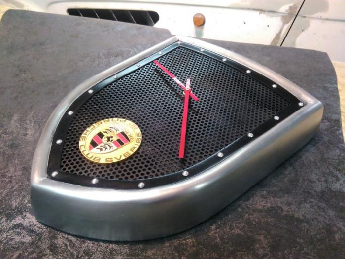

The technique I use is called hammer-forming, used on both the box and the Porsche clock.
Good resources are Ron Covell, Peter Tommasini and David Gardiner among others.
Ron has a movie dedicated to hammer forming:
http://covell.biz/hammerforming-techniques/
The details on the lid are made differently though.
1. Make a die of the shape you want. Can be of metal, wood, plastic you name it.
2 Make a "sandwich" bottom-up : The Die, the sheet to form, a urethane pad or hard rubber, a thick steel plate
3 Place that sandwich in a press and squeeze.

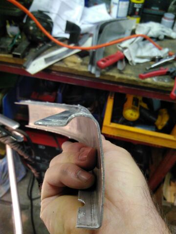

Below is an example I made with a steel die in 0,5 mm stainless

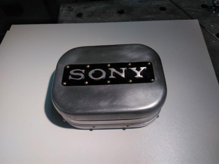

Bench shear, jig saw and files. All hand crafted
Yes, they are spot welded. If you zoom in you can see the darker spots.
Laser cutting would had been a lot easier but this was just a fun weekend project at a Metalmeet in Norway.
