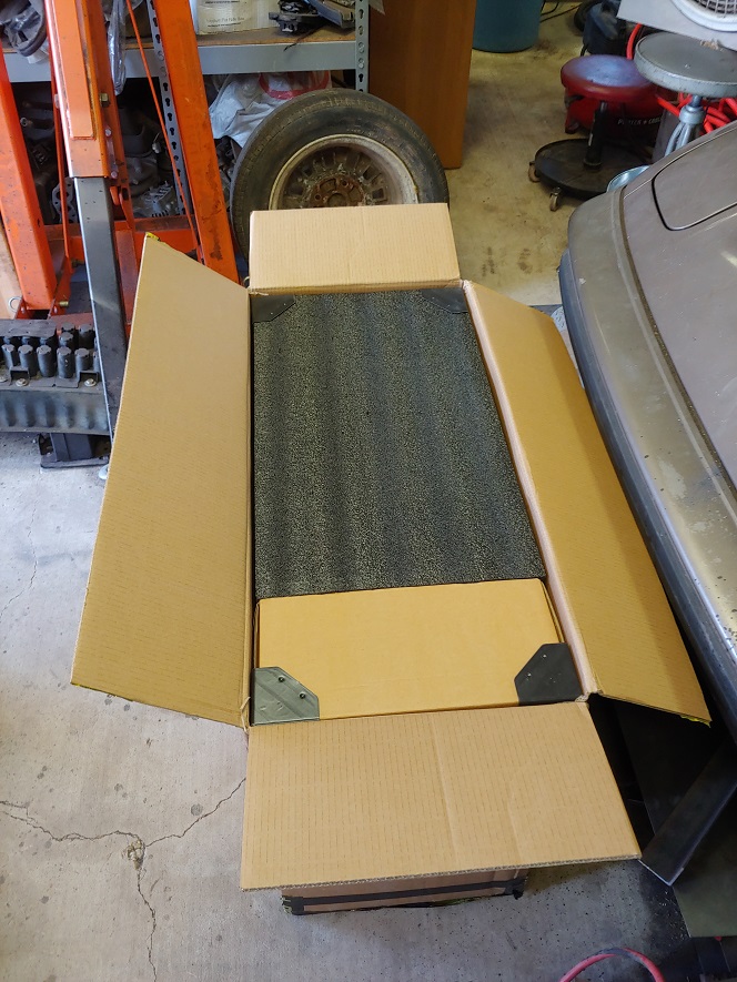

First was the unboxing. Like everything I see associated with PrimeWeld they took care to package the contents of the 225X box quite well:
Which included several small packets of rodent deterrent inside the box plastic cover and within the box itself:
The same held true for the CUT60, BTW. All of which was a welcome sight with me. Thumbs up PrimeWeld, good call!

In the case of this 225X box, there were even protective corner pieces at the top of the box! They were plastic while the bottoms were metal, but even so that was impressive to see:
And customarily the prongs of the electrical plug were protected as well:
Which gives me warm fuzzies, I must admit. And yes, I do replace those plastic covers after using the machine.

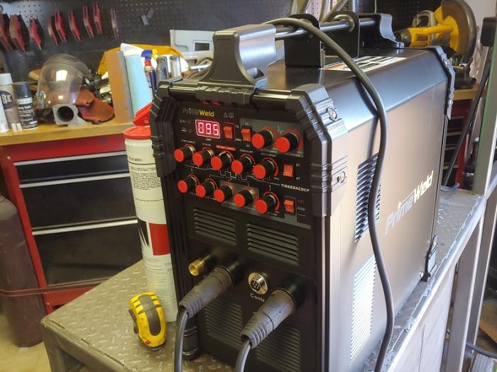

Having nowhere else to put the 225X, I slid the green box over and put it on the MIG welding cart:
Next the very first thing I wanted to test was the functionality of the buttons and dials. They all seemed to work, but clearly I didn't not have time to verify that. I did notice that when in SMAW mode, my box maxed out at 185A instead of 180A, thus:
So that was kinda interesting.

You'd could run a 3/32" 7018 at about 90-95 amps, that *MIGHT* work on a 30 amp 120v, but I honestly don't even have that in my house, all of my 120v circuits are 20 or 15 amps AFAIK. Better would be to run 6011, could knock it down to about 80 amps with a 3/32", that would probably run ok on 20 amps.av8or1 wrote:The max output amperage in SMAW mode on 110V is reportedly 120A. If that's the case, how would you run a 7018 rod?
Honestly I don't plan to run too much stick on mine, will probably use my green weenie for that, it's quite a bit smaller and has a strap to carry it on your shoulder. Also has an Arc Force knob, so has some adjustment on the stick arc. I haven't used the green weenie in quite a while, since getting the Primeweld actually, so maybe I'll try to run some rod on it tomorrow and possibly see if it will even burn 6010.
For the Primeweld I will most likely only use it on 240v. To date I have not run either of my welders on 120v.
As I have said, I run mine on a 30 amp 240v circuit, haven't popped the breaker yet. Can run 1/8" 7018, 6011 and 6010. I have some 7014 and I think some 7024, but have only run those on the green weenie.av8or1 wrote:Then the recommended breaker is 50A on 220V when none of the max input current values for 220V are higher than 40A.
I will use the Primeweld mostly for tig.
That looks similar to the Lenco I use on mine, but I use a 300 amp as it's a bit smaller than a 500 amp.av8or1 wrote:And if one was to upgrade their electrode holder, this is the one that I would recommend:
I also use a Martin-Wells stubby, I like it also, but the Lenco is easier to snap loose of a stuck electrode.
I think I posted pics of my 2 replacement stingers.
However to be fair I compare them to the ground and stinger included on the green weenies. They are actually substantially better. The stinger supplied on the green weenies is wonky and the jaws twist easily and the ground clamp is not as good either. Jaws quite a bit tighter on the Primeweld stinger, and jaws don't twist. I don't use either of them, I made my own ground clamp and use a Lincoln, it's stamped steel but larger with copper rungs in the jaws.av8or1 wrote:So that was to-the good. Now contrast that CK torch with this:
My one comment on the knobs, the amperage knob is very sensitive. That is true on my green weenie as well.
