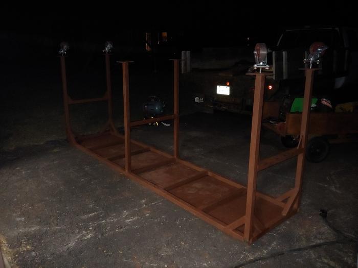

All's well that ends well. The gusset welds came together despite some less-than-ideal fitup in one or two cases and I handled the rod even better tonight than last night. Heck, I even used some 7018 to complete a few additional tacks in order to consume the entire rod! I ground all welds down, 'cept the tacks, and applied primer to everything that needed it:
storage rack 35.jpg (226.04 KiB) Viewed 3939 times
And I felt much better now that all 4 feet were completely welded. That was the most fun WRT welding on this project to-date actually. That's because with those feet being 1/4" plate, I could increase the amperage on the welder and run a proper bead. Granted, the verticals are still 1/8" tubing, but I kept the focus of the bead on the plate and just allowed the bead to weld up to the tubing, careful to penetrate into the joint. Those were cheese! :lol:

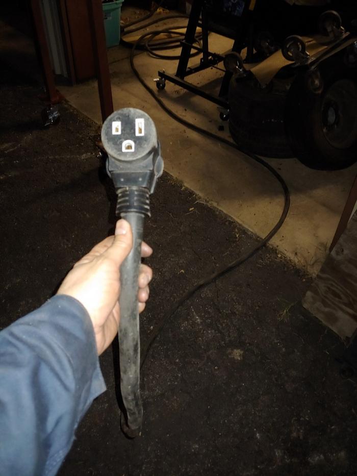

And this CJ is how I power the toys out front:
electrical power 1.jpg (64.45 KiB) Viewed 3939 times
I simply string two 25' long, 6 gauge cables (from Eastwood) from the Nema outlet that I cobbled together. That does the job, though it dwarfs the largest-available cable from the box store that I used when I fashioned that pigtail to work with the 240V outlet that the electricians installed. :D

av8or1 wrote: And this CJ is how I power the toys out front:
I have and sometimes need to use a 50' extension cord as well. It's one of those beefy RV power cables. Damn thing weighs about 60# but works a treat.

cj737 wrote:I have and sometimes need to use a 50' extension cord as well. It's one of those beefy RV power cables. Damn thing weighs about 60# but works a treat.
Ah yes, I'm familiar. I'll bet it does indeed work for ya. The 6 gauge cable isn't heavy-heavy, but it lets you know it's there. I like running the toys off of it, though each time I do I remind myself that I need to rebuild that pigtail to use the same gauge wire instead of the stuff I got from the box store. :D
storage rack 53.jpg (72.45 KiB) Viewed 3646 times
Which are too small to serve any real purpose, but they might look ok if I used them in a similar fashion as the others. So I mocked them up:
storage rack 54.jpg (67.56 KiB) Viewed 3646 times
Naturally, with the full weld bead that these joints have after last night, if I was to do this properly, I would need to grind out the middle 1/4" of that weld to insert these, then weld them in. Yeah, not gonna do that in this context. It was at that point that I decided to have a little fun with them. I opted to use them anyway, even though the gap was horrible; just close the gap with some weld. :lol:
It was kinda fun to do that, though as always that generated an unnecessary time sink. Oh well. Have a little fun with your projects I say, especially when you're using material that would have otherwise been scrapped and that material serves an aesthetic purpose only. I mean why not?

To insert the triangles you wouldn't have to touch the previous weld, just nip the one corner of the triangle off with a zip wheel or just grind it off. Say a 1/4" or so. That'll give you the clearance over the weld. That's usually how I do with corner gussets like that. Leave the weld, just make the gusset fit over it.
av8or1
JayWal wrote:To insert the triangles you wouldn't have to touch the previous weld, just nip the one corner of the triangle off with a zip wheel or just grind it off. Say a 1/4" or so. That'll give you the clearance over the weld. That's usually how I do with corner gussets like that. Leave the weld, just make the gusset fit over it.
Ah yes, of course! Thank you for the feedback Jay! 'Obvious now that I think about it, but that idea, although I am certainly familiar with it, didn't come to mind at the time. Not sure why, but it didn't. This, amongst other reasons, is why I still consider myself a newbie to the fabrication thing. That idea should have been readily, overtly present in the gray cabbage upstairs. Oh well. In time perhaps.
Thanks again!
