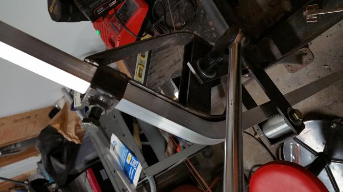

Make the tools you need,all kinds of ideas an plans on the web,if you hAve a welder an the ability to cut stuff,you can make what you need,or buy it,somewhere on here I posted a square tube bender,that I built because I had no way of doing it,it worked great
- 20170320_175936.jpg (42.7 KiB) Viewed 1976 times
- 20170320_175523.jpg (40.71 KiB) Viewed 1976 times
- 20170329_222554.jpg (47.04 KiB) Viewed 1976 times
