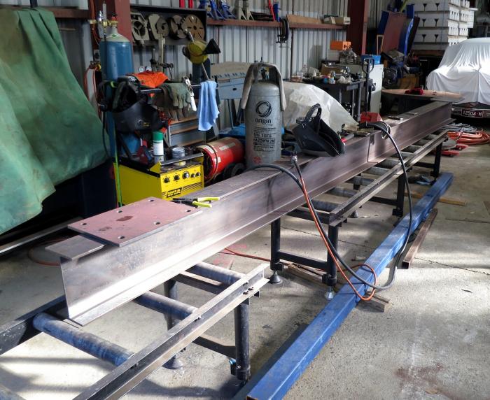

So I went and purchased a 15 year oldWIA copper core 335amp 415v Mig from a defunct manufacturing company. I fully serviced it, new bezel, tips etc and started to learn the tips and tricks to the more powerful welder.
I built a sturdy girder trolley to allow me to handle the 8.6m long rafters. Here's a shot of the girder trolley and the two Mig machines.

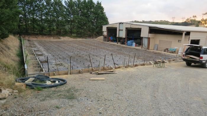

Here's the formwork coming together for the two shed slabs. It took me most of a year to excavate, prepare the area, stone compacted base, steel reinforcing, formwork, boxing etc. All on my own.

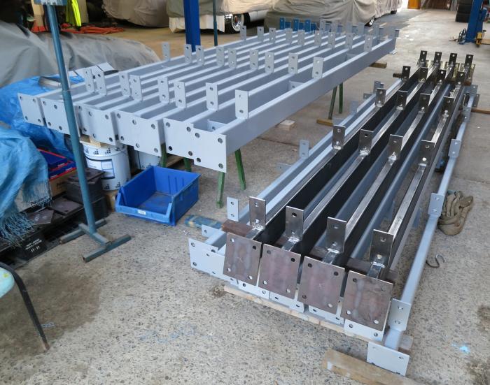

So I made a start. First by getting used to the welder, and materials and made up 156 cleats and brackets. Then I got onto the columns and rafters for the small shed. The wife (Suzie) did all of the primer paint and then I sprayed a nice hammertone top coat onto the finished frames.
