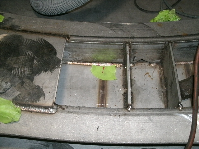

This leak is challenging me. It is "travelling", meaning it is following a path created by other weldments in the vessel.
You'll notice I've sectioned out a 6" length of angle iron from one of the hoops. Helium introduced to the end of the hoop, on the right, shows a leak. This means the leak is under the angle, between the two fillet welds that attach it to the vessel. To narrow this down, I have to stop-drill the angle to break the path between the fillets. I have so far shown that it is more than 12 inches from my starting point, but the leak rate was twice what it was before, and indication time was half, so I hope to find the leak is within the next 12 inches.
Steve S.

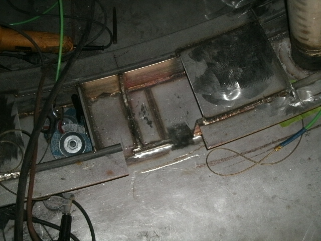

FINALLY found it..
Here it is, with dye penetrant:
The leak was 38 inches from where I detected it, as shown here:
It was directly under the rolled-angle hoop, between the two fillets, and was likely a flaw original to the metal that was missed at x-ray because of the hoop of 4" X 2.5" angle welded directly over it. I finally located it by stop-drilling the angle at the weld every ten inches, cutting to the bottom of the angle at the drilled hole with a die grinder, and using a small flow of nitrogen to "interrupt" the helium I was testing with. Once I found a ten-inch section that tested positive, I halved it, and narrowed it to five inches. I sectioned that 5" out, ground and buffed to clean metal, and began testing small areas. Once I had a positive result, I hit it with the dye-penetrant, and there it was!
Now, they've decided to get engineering involved in deciding how to fix it, so I guess I'll be on another project for about a week.
Steve S.

I finally got an answer from engineering...
It was exactly what I expected, and was planning; Today I started opening the outer vessel where the leak is. I'll be sectioning out a 12" square (okay, with the corners rounded) of the outer vessel, and peeling back the insulation in layers to reach the "outside" of the inner vessel so this crack can be welded and back-welded. I'll have pictures, of course.
I hope they feel the engineer made his paycheck, by recommending what I was planning to do anyway...
