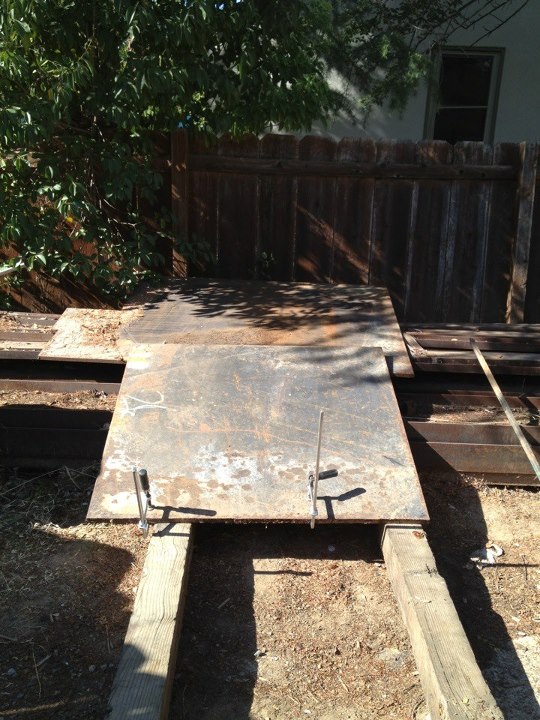

So I decided to make my own welding table. After searching for a good table, the price was just way too high to justify the cost. I located a 1-inch plate 48"x44" on Craigslist. It was quite the task getting it home, but proved to be worth the effort.
Here is a picture of the plate before its transformation into a welding table:

If you don't mind me asking..............what did it cost you to have the water jet work done and to have the precision grinding done ???
WerkSpace and Otto (Steve S), both great ideas! Thanks for sharing.
Rahtreelimbs,
The Waterjet cutting cost me $300. The Blanchard grinding was going to cost me $200 (another place quoted me $600) but when I showed up to take my plate top home and pay for the Blanchard grinding, the manager there said, “Its on the house brother.” -I was shocked! Talk about “Pay It Forward.” This man’s kindness infected me and has continued to bless others. Very cool!
Edit: Recently looked at the receipt for the water jet cutting. It was more then what I remembered it was. $365 + tax.
