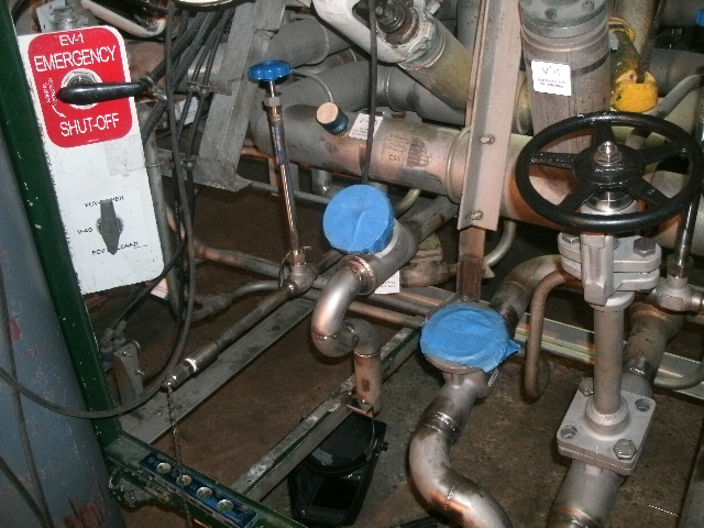

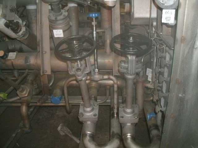

The first image is
Sorry about the quality of the second image. I took two shots, and thought one might be good.
Sooo... restricted welds with a "capital 'R'."
It actually makes for a pretty pleasant week, 'cause nobody bothers me (afraid I'll ask them to help) and I get to test all my skills, including close-quarters mirror-welding.
I'll try to get a better shot of the gallery the valves are going in.
Steve
of the valves I have to jamb into the second image. I'm changing out a number of valves notorious for losing parts into the process stream, but I don't have the luxury of spooling all this pipe on the bench as the original builders did.What welding projects are you working on? Are you proud of something you built?
Here's the body of the first 2" valve, in it's final position.
Steve
Steve

Hey Steve,
What kind of NDT is required on a job like this? Also how do you cut out the old valves?
Mick
Mick
Hi, Mick,
Strangely, all work done downstream from the safety interlocks, called "fire control valves", is only inspected visually and with a bubble leak test, and I do both myself. I was prequalified for the welds, but it's generally up to me to do it right and prove it. The only part of the trailer that falls under a qualified welding code is the inner vessel, covered under ASME section IX. I also perform the five-year retest under that section, with an exemption. The normal procedure requires test at 1.5X max working pressure. Under the exemtion, I test to 1.25X MAWP.
For the 1.5 and 2" valves, I simply hack out the old valves with a sawzall to eliminate the weight, then trim pipe ends to length with a cut-off wheel (The new valves' bodies are a few inches longer than the originals, requiring major refit). The small-bore valves are much closer in size to the ones I'm replacing, but are socket-weld, so when I have decent access I cut the welds to remove the valves. When I don't, I'll section out the pipe to the points easiest to weld in that line.
In either case, I vacuum out the debris, and at the end of the project pressure the trailer with nitrogen and go through a procedure to blow out each affected line.
Steve
Steve

Good question. I hadn't thought to mention that.mArc wrote:Steve,
Fascinating thread.
Can you elaborate on the reason for having to replace all the valves? Do they become embrittled or otherwise deteriorate because of the hydrogen?
The Powell valves I'm replacing have a tendency to lose parts into the process stream. The way the poppet seals are retained is apparently succeptable to loosening from extreme thermal cycles (ambient to -423F almost instantly) and the vibrations any part on a moving vehicle suffers. On three of the 1/2" valve in this trailer, the poppet seal, seal retainer, and retainer nut were gone. I did find one retianer in the liquid sample line, because the connection port was too small for it to escape.
The new valves are designed specifically for cryogenic temerature cycles, down to liquid He (-458F). They've been commonly used on another manufacturer's version of the same trailer for years, and in the rebuilds I've done I've never seen a "loss of parts" failure.
Steve
