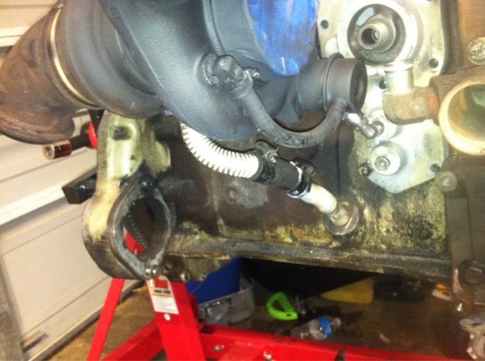

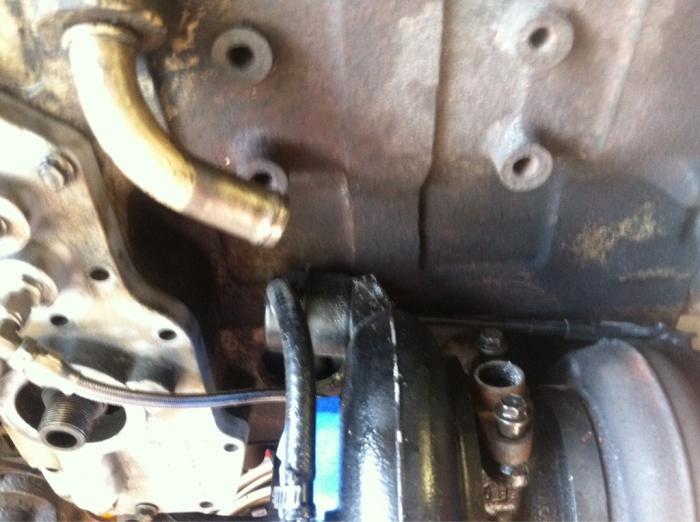

After cutting down a 5.9 manifold to fit my 4bt going in my jeep I needed clearance between the turbo and oil cooler so this is what I came up with

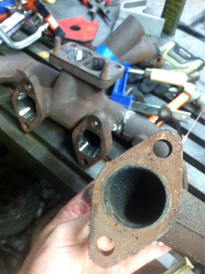

Here is the manifold modification

Awesome again!! ;)

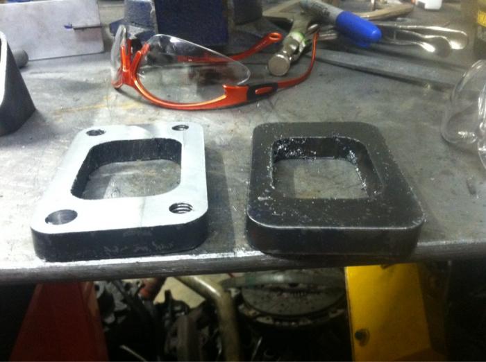

    Fri Nov 14, 2014 5:13 pm

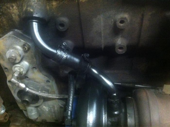

Installed new oil drain
This is what I had before I moved the turbo

great job. is there a write up on your manifold cut and weld?
pigpen60 wrote:great job. is there a write up on your manifold cut and weld?
Not yet, but I can do one
