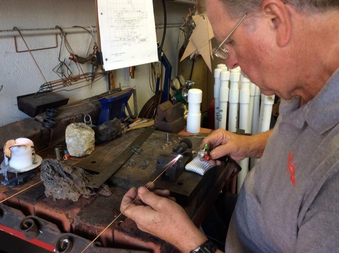

My current project is a B747-8 aircraft model. Just started and have a few hours left until completion. Note in the photos, I'm using a "Tig Finger". The slab of steel I use to keep things straight gets too hot to touch...not anymore.

The How: I use 3 view drawings. From those drawings I make ratios from the real aircraft to my model. My sculptures are not to scale, but are proportionally correct. I start with the profile view and make the profile using (usually) 3/32, R45 mild steel filler rod. Heat and weld until the desirable shape is attained. Looking at the front, side and top (I have a portable vise that I can get around 360 degrees with my torch in hand), I fill out the fuselage. I make welds as careful as possible paying attention to where the flame is directed so as not to destroy something I've already finished. I measure the lengths of the wings. I have been making the trailing edges from 1/16, R45. With the trailing edges welded to the appropriate place on the fuselage, I form the leading edge, using 3/32, R45. I 'fill' the wings with 1/16 rod, welding leading edge to trailing edge, parallel to the fuselage, spaced aesthetically correct. I make the engines by 'guess' and position them by measurement. I pay a lot of attention to all of the details, all of the time. Angles have to be correct, shape is very important, and accurate. I finish the projects with a stand of some appropriate size and shape. I have used many different kinds, and some experimentation leads the way to the 'right' base or stand.
I have a Victor JT28 torch (it was old when it was given to me 45 years ago), with tips ranging from 000 to 3. I usually use the 000. I also have a Smith 'little torch'. It produces a very small flame, yet still 6300 degrees and will produce a nice burn as you pass it across your skin (you know). I use 6lbs Acetylene, 12lbs Oxygen, Neutral flame.

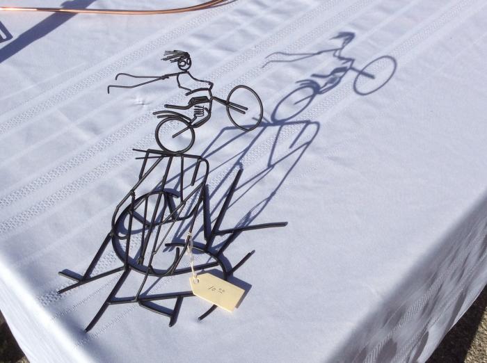

- image.jpg (51.75 KiB) Viewed 1342 times
Here is a bunch of pieces of scrap that I had fun withmcoe wrote:I have tons of little scraps laying around especially pieces of welding rod and I refuse to throw it out because you never know when you will need them. A lot of times I will play around with the pieces of scrap to just fine tune settings. Looks good by the way.
