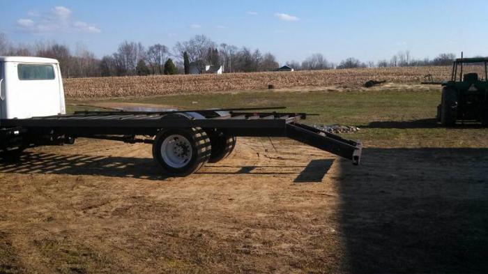

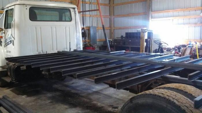

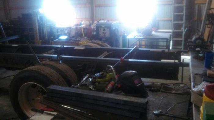

I have antique tractors that I pull and play with. But don't have any way to haul them. So i bought an international truck. Needs a deck.here's my progress.[attachment=-1]uploadfromtaptalk1396473762105.jpg[/attachment][attachment=-1]uploadfromtaptalk1396473780525.jpg[/attachment][attachment=-1]uploadfromtaptalk1396473805039.jpg[/attachment]

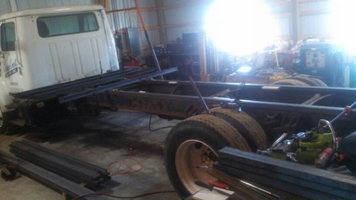

[attachment=-1]uploadfromtaptalk1396473905556.jpg[/attachment][attachment=-1]uploadfromtaptalk1396473917862.jpg[/attachment][attachment=-1]uploadfromtaptalk1396473934371.jpg[/attachment]

Does it have enought clearance for the tire when it is fully pushed up? In case the truck is loaded and hits some bump on a road... :roll:
    Mon Mar 10, 2014 6:49 pm
    Michigan
I have john deeres. There is about 5.5 to 6 inches from the tire to chanel . Being its not air ride I thing I should be fine.

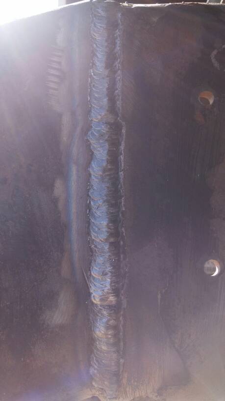

Here is a picture of my up hill 7018 cap on beaver tail / frame.

Looks great! We did a Chevy C65 several years ago steel frame, 2-1/4" oak deck. Mine is rack body dump. I kinda wish we had gone with steel deck. We cut the trees, trucked with the same truck, and had enough oak milled for two floors. Lost my lumber storage when Hurricane Irene damaged the building, so now 7 years in I need new wood. I might better have sprung for steel in the first place.

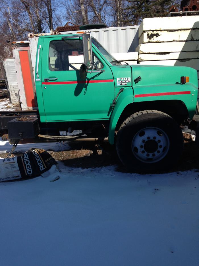

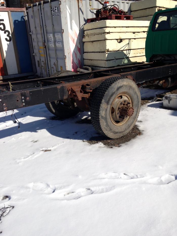

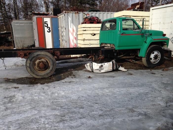

Thanks. I used a section of frame off an early 70s late 60s ford f600. For the beaver tail. Cut out the section I needed and welded it back tougher. Was going to scrap it but looks to cool to get rid of. I will get a pic.

[attachment=-1]uploadfromtaptalk1398016618836.jpg[/attachment][attachment=-1]uploadfromtaptalk1398016636945.jpg[/attachment][attachment=-1]uploadfromtaptalk1398016650796.jpg[/attachment]

The blue truck is the f600. I took a section of frame out of.

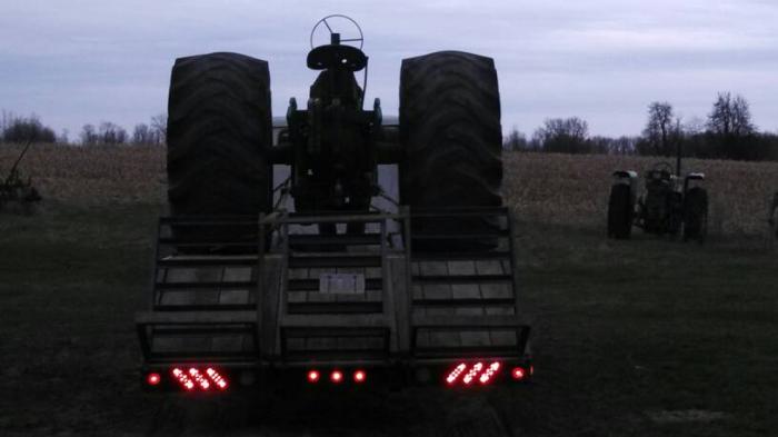

[attachment=-1]uploadfromtaptalk1398729322056.jpg[/attachment]
Sent from my DROID RAZR HD using Tapatalk
    Michigan
Truck is usable but not finished.

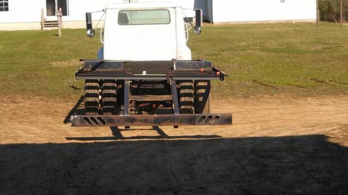

[attachment=-1]uploadfromtaptalk1398731995694.jpg[/attachment]
