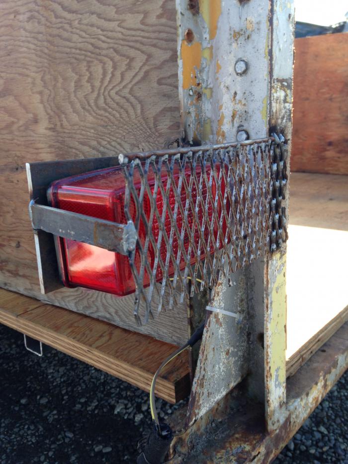

    Wed Oct 23, 2013 3:30 pm
    Palmer AK
Here's the tail light guards...
I like them.

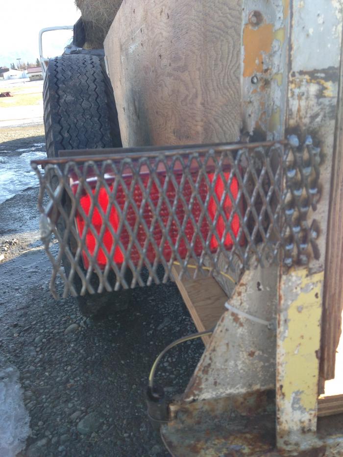

    Palmer AK
Here's street legal....
I'm gonna be working on fenders and running boards for the side and put a ramp/tailgate on the back...
More pics to come.

Am I missing something? Like a suspension? I assume you aren't planning on going far or fast with it.

You are correct, no suspension....
This trailer I saved from the dump, the first pic in this thread is that is looked like before I touched it....
It will do the job, just wont go over 35 with it....
Any cautions on it?
~John

No, if you aren't going fast then you should be good. It looks like more of a trailer to pull behind a tractor with an axle welded to the frame but you aren't getting on the interstate or going far so....I'm all for recycling. In my state you need fenders to pass an inspection. Your state may vary.
Oh, if you ever have a tire blow - which is a distinct possibility with that old rubber - do you have a plan for a spare tire?

At those speeds, run it with the tires inflated just enough to look like a "low tire" for the load, and your tires become your suspension.
Just a thought...

Oh, one other thing. I like the idea of a piece of expanded metal protecting the lights. But it looks like you don't have enough room to take off the lens when - not if, but when - the bulb goes.

And too the lights, good thinking, But there's a cover that comes off the bottom, so I can change the bulb....
