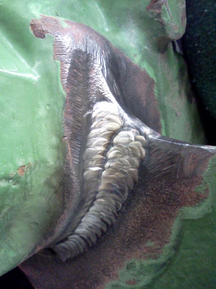

Walking the cup on some cast iron repair I did. 309L Stainless filler 3/32 red tungsten DC.

Looks good! Let us know your process for this repair.

Thank you. I use a warming plate to warm the cast to the touch, no torch or fast heat, use a gas lenses 20-25 gas psi argon, go very very slow. 3/32 red 1/16 309 ss filler dc setting I cant tell you amps specifically I just float the pedal maybe 180-225?
