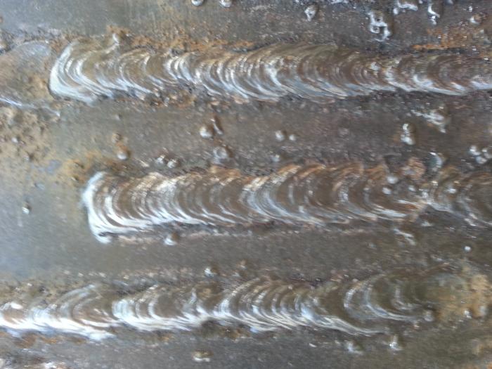

Tell me where I went wrong and any suggestions and tips would be appreciated.
I was using 6010 at about 95 amps...
The only thing I see wrong is you aren't "welding".camlott55 wrote:Tell me where I went wrong and any suggestions and tips would be appreciated.
"Weld" two pieces of metal together and show both sides after you're done.

Practice, practice, practice, take a look at Jody's video on running beads on a flat stock just like you are. Rod angle and speed and watch the puddle forming behind the arc and try to keep it as constant in size, width and height. Also keep an eye on the length of your arc, looks a bit like your long arcing a bit but that gets better with practicecamlott55 wrote:Tell me where I went wrong and any suggestions and tips would be appreciated.
http://www.weldingtipsandtricks.com/stick-welding.html

camlot55, this should help you considerably....
http://welding-tv.com/2013/11/05/6010-pad-beads/

+1Marc Godwin wrote: Practice, practice, practice, take a look at Jody's video on running beads on a flat stock just like you are. Rod angle and speed and watch the puddle forming behind the arc and try to keep it as constant in size, width and height. Also keep an eye on the length of your arc, looks a bit like your long arcing a bit but that gets better with practice
I watched lots of Jody's videos, and still do the night before I weld - as mental refresher.
