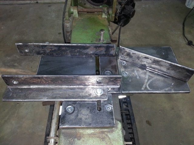

For the new base and clamping "system", I wanted to be able to hold stock at 45 deg on both sides of the blade. The stock system/clamp of course can't do this, so I gave up on it, and went to a simple model where (similar to welding) I just clamp the piece to the base. It is more work, and much slower, but I can now do things I could not do easily before. So not an "improvement", just a different way of holding stuff being cut. In fact, I did this first, and cut every single piece for the new stand using the new "system".
The new base started life as a scrap piece, 3/8" thick:
After removing some of the high points in the mill:
I started cutting it to "fit" - the idea being that it had to extend past the current "base" in order to allow me to clamp pieces to be cut to this new base:
Fast forward to having everything drilled and tapped:
I then started work on the first of two fences (one for each side of the blade):
After some more work, and drilling and tapping, I now have one of the two fences ready:
I then cut the fence flush, and allow the blade to go through the surface of the base, without going completely through it:
Now, to align that fence, I align it to the cut/groove on the base:
So now to cut something, I camp the piece to the base, using the fence for alignment:
Or use another piece of angle iron to clamp the piece to be cut to the rigid fence (similar to the stock clamping system):
I then worked on the other fix fence, for the other side, which will only be used to make 45 deg cuts:
With the hydraulic piston, I can get the blade to within a small distance of the piece, and measure accurately:
So using the new "system", I cut the pieces, and checked the basic design by stacking the pieces - surprisingly it could stand on its own!

I braced up the rickety stock base a long time ago and mounted it to a roller platform and it works for me so I will keep it the same.
I really liked the front table so i added one with a fence, both of my fences have threaded locater holes at 90 and 45 , anything between will be clamped in place. It goes without saying the front fence will only get used for that reverse/oddball angle you cant clamp in the back.
The larger rear platform let me extend the stationary fence and the hold down fence, the 1/2 holes will hold a piece of threaded rod as a spreader for clamping shorter work.
The awkward clamping on these machines made me use it more vertical than horizontal but i think it will be much easier to use now.
Next will be a hydraulic downfeed (once i get over the sticker shock). The ones i see on ebay are $90 ,anyone have a cheaper solution?
