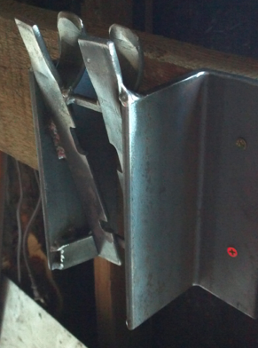

I would like to share with you all my documented build up of a portable bandsaw table saw bracket. You can check out the step by step build here at this link http://www.instructables.com/id/Keep-yo ... ortable-b/ This bandsaw cradle design preserves the portability aspect of the saw while also holding the saw vertically for sweet table cutting operation. No plugs, hardware, clamps or brackets get in the way, which in turn facilitates a fast transition from the vertical table mode to portable cutting action.

Here's mine framed in aluminum. I notched the table to bolt flush on the stock mount. It lets the motor fan help blow the dust away from the blade so it is easier to see the scribed line on what is being cut. 8" x 8" table. I use the heck out of this thing now.

Very nice work TamJeff, sweet knife too. I see that your stand is small and light enough that it can still be used the way the saw was intended. Thanks for sharing your build. I love the exhaust blowing away the chips too. My Intent with this post is to show people that there is an alternative to the common unitasking table saw stand design and that the portability function does not need to be sacrificed in leu of vertical table saw cutting action.
I noticed that about your design and actually thought about something like that initially for here at home. I made it an in between, I guess. There is only one bolt holding the saw in and I made it to where the stand is also a carry handle. I really made this to where I could carry it into a boat. The boats I work on are on trailers and even with roll around stairs, fitting with having to run back and forth to the stationary bandsaw is a chore. I sometimes would have to make 20 trips or more in and out of a boat. This pretty much saves that. Now I can just bring all the rough cut parts with me and nibble away at them accordingly.

Hello. I was after a picture of just the frame. I'm getting a cheap portaband saw and after some ideas of just the frame.

Here's another view. I did it after work so there was no real engineering and it was made from bits at the top of the scrap bin and my junk drawer. I can take it apart with just the one bolt but I left my camera at work so it may take a day or two if you want to see just the frame. I built the bottom offset "H", set the saw on it and went from there. I thought I was real slick, until I noticed the cord would hit but it was already tacked together and I figured (yeah right) that I could always fix it. It works a treat at any rate. It's held in place with the allen bolt that holds the front knob on.
It was one of those projects where you are really ready to go home and your under drawers are no longer form fitting as they were when you started the day, so you just start throwing chunks of metal and weld at it till it stays put. It was still warm when I put it in the car.
It's made out of 1 x 2 and 2 x 2 aluminum box, a bit of 1/4 x 2 and 4 and a piece of sched 40 1.5"
