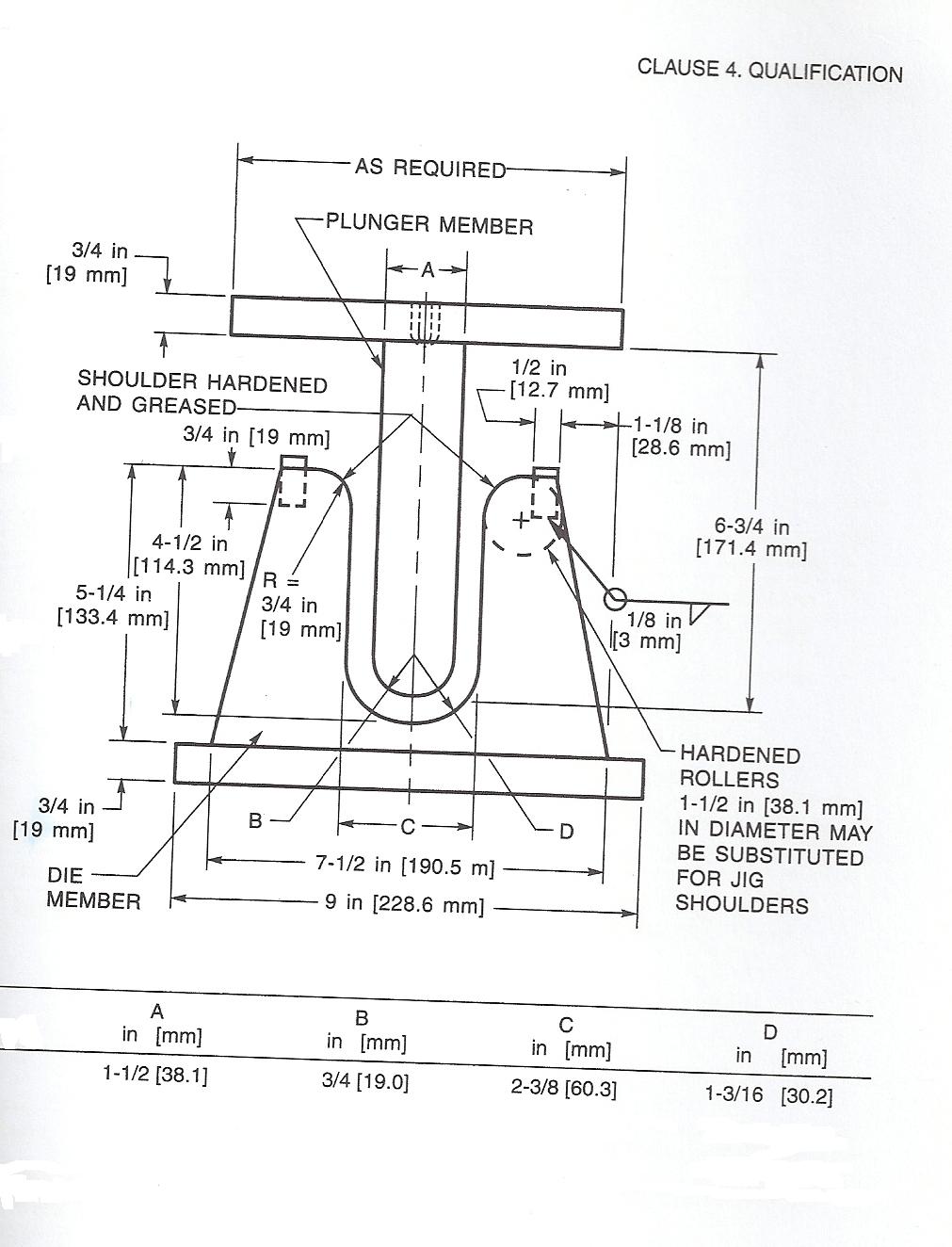

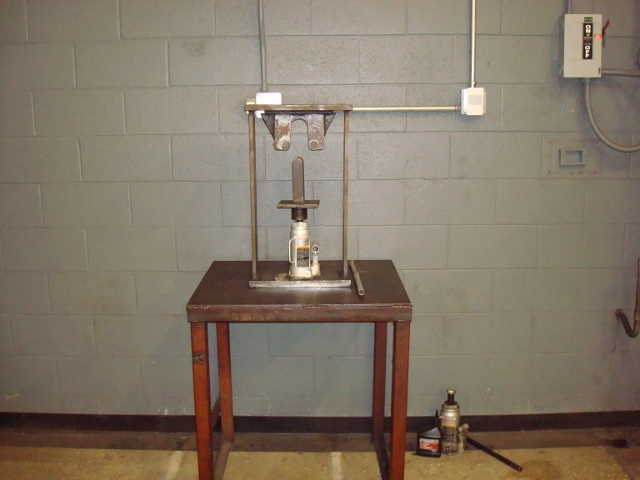

Ok, was tasked to fab a guided bend test jig for 1/4" 1018 CRS to do face and root bends. I've tracked down a 20tn bottle jack,1/2"X4" steel plate and have all the steel rod you could emagine. Only thing missing is plans.
I've seen one somewhere on the web where the jack is mounted in the fabbed U shaped base and makes the bend upward so you can see the face of the bend. This making any sense? :?
Is the rule for spacing and dia?
3x thickness= dia. for male bender.
3x thickness of sample +2.2x thickness of sample= spacing for the 2 outside guides inner distance.
So.....
3/4" dia male guide and 1.300" spacing between two 1"dia guides.
I'd hate to fab this thing just to find out it's wrong.
Someone spot check me please!!
Thanks!

Sorry about the missing info. It's 1/4" plate in the flat position to D1.1 standard.
The school here wants to start trying to get the students an AWS cert and the program is pretty short so they're looking at 1G, ASTM A36 1/4" plate as the easiest. They only have 30 hrs of SMAW in the program (all positions, G and F)then they have to move on to other processes in the course.

Preliminarily, I agree with the numbers you gave regarding bends. I'll run it by a few people "in the know" and try a little research of my own, to try to confirm those specifications. To actaully give a AWS D1.1 cert, I wouldn't be surprised if the bend jig has to be checked by a properly rated CWI, so it needs to be right.
No side bends, I take it? Root and face only?

Whiterabbit, I have the drawing for the bend-test jig, directly from AWS D1.1. I'll try to post it here, and I'll send it to you in a PM. I'm grateful to some new friends on another forum for sharing it with me.
EDIT: discovered I had the option to send it directly to your e-mail address, and did so.

Here a picture of the one used in the Welding School I attend. I will check to see if there are others and will post picture of them.
Bending fixture.jpg (159.87 KiB) Viewed 1911 times
