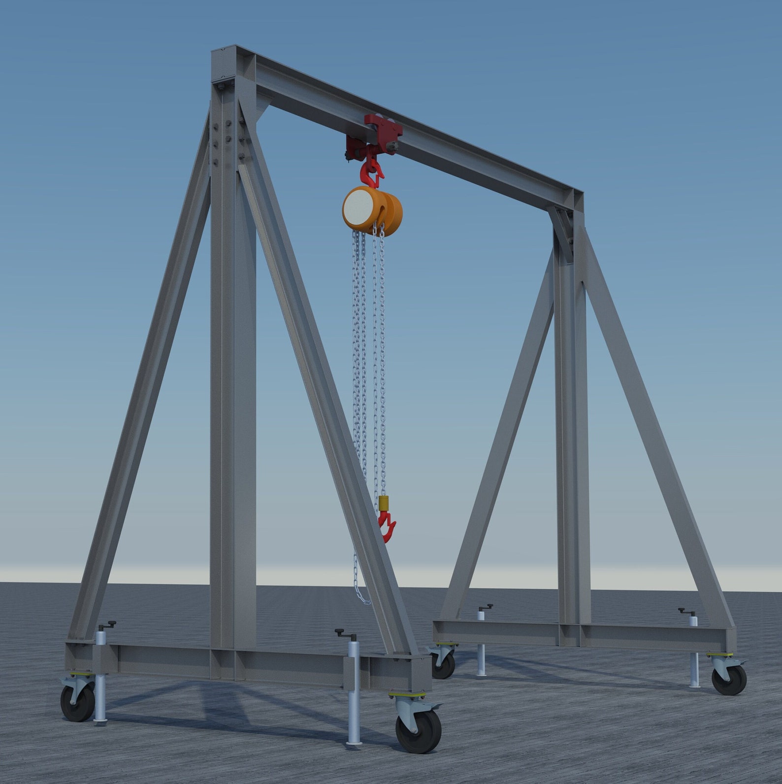

hello, I'm just setting up my welding workshop, I don't have cranes or forklifts, but for the heaviest jobs I would need a frame to hook up a chain hoist to set up a sturdy and effective temporary crane, modest capacity around two tons, with a useful height between 3 and 4 meters of useful height and a gauge of about 3.50 meters of gauge some useful suggestions thanks greetings.
any photos, any drawings to draw inspiration from? Thank you
Width: 3.6 meters
• Height: 3.2 meters
Dimensions: reach 3.6 m, height 3.2
Weight: 480kg*
Materials:
1x13m 152x152x23UC
1 x 13m 120x55x13 Channel
1 flat bar of 6m 70x8
4 x 6"-8" Heavy Duty Caster Wheels
workshop gantry 3 ton
Size: Span 3.6m Height 3.2
Weight: 480 kg**
A mobile gantry A-frame ideal for lifting operations either DIY in your garage or in a light industrial workshop. Capable, steady and durable.
Shop drawings are included with only 6 different assemblies using standard steel sections.
Materials:
1 x 13m 152x152x23 UC
1 x 6m 70x8 Flat bar
4 x 6"-8" heavy duty castor wheels

if you use an electric hoist it must be certified if it is manual and you use it it depends, I have no employees it is a structure that I will have to use, how do you advise me to conceive and build it economically? it must be light and handy to use and clearly robust to support high loads, thank you. better all H-beams or I can do a mix, the H-beam and the lateral feet in tubular and box-shaped, what do you recommend??
I beam across top, square tubing for verticals, angle iron for “A” legs. I beam for side legs.
If you construct it laying on its “back” then you can get some help with a few strong pals and a rigging rope to tip it up onto its casters. Casters will make the crane portable and useable. Constructing it properly is always the trick.
I found out if the device is equipped with an electric hoist with a capacity exceeding 350 kg it must be certified and accompanied by a project by a professional such as an engineer

I built a gantry by hand with no machinery assist such as a forklift. I did however assemble it, then used my F-450 diesel dually to stand it. Then added casters and later trailer wheels and tires for better maneuverability on uneven ground.
