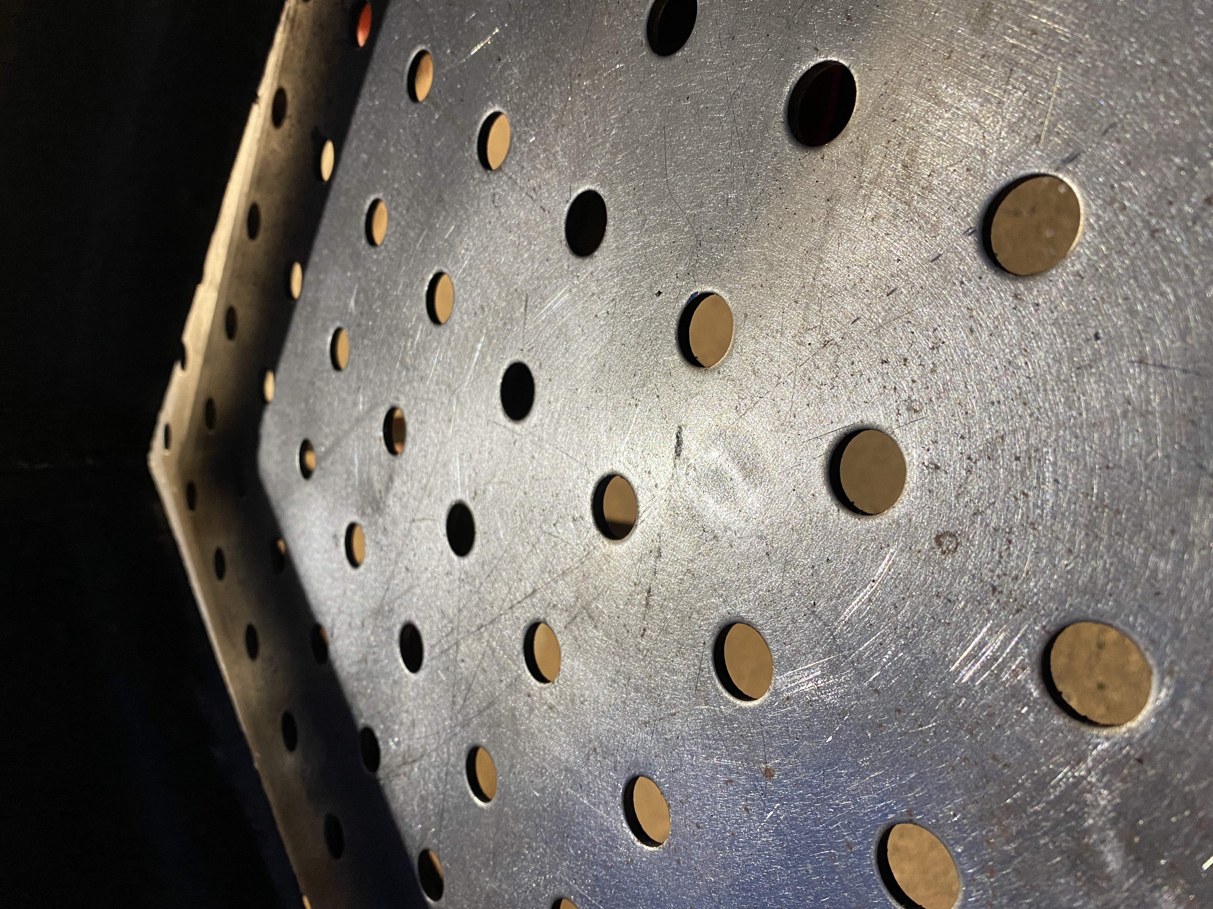

Hello!
I recently created a 1.5"x1.5"x0.125" angle iron frame to mount a ventilation fan to a connex container. I added 1/8" plate "walls" to the frame to give me some depth, given the corrugated nature of the construction of the connex. With that said, I TIG welded the frame itself, and it was very flat and square. I then stick welded the "walls" for expedience, and (like a dummy) I assumed because the frame was already welded and square and flat, that it wouldn't distort much. I was VERY wrong!! The frame is now bowed by probably 1/2" from corner to corner, and two corners are about 1/4" out of square.
With all of this, is there any way to save this thing, or do I need to just start over? Given the cost of metal, I really hope I can salvage this thing.
Thanks in advance!
Gdarc21
    Wed Aug 04, 2021 6:44 am
This is one of those things with welding that is useful and horrible, when you get used to predicting.
You can, using a stong clamp put packers under the edges and pull it down with the clamp. Its important to note that the bend moment needs to be found. For instance a beam that is 6 foot long and looking curved may only be actually bent on 2 to 3 spots and they are usually welds. So give a bit of space either side of it and pull it down.
Adding heat from a gas torch even a plumbing one will help to localise and control the repair with out making worse.
1/8 inch could even be secured to bench and hammer-assisted :)
Photos, for us, of how it looks would help too

Having just modified a few of these containers for the Navy, and building one for my eldest, I will wager that the frame distorted because when you cut the corrugated sheet, you did not tack in stabilizers from side-to-side. Without a “restrictor” the corrugated name will billow and bulge from the welding.
Can you fix it? Yep, cut out the frame, tack the stabilizers in, then tack and weld the frame back. You can test the flatness of the frame once cut free. You should be tacking that frame around the perimeter every 12” or so until the side panels are secure and stiff. Once welded and everything is cooled fully, cut the stabilizers out.

Thank you for the information. Yes, I was fully welding the seam to try to make it as water tight as I could. I had not thought of welding on stabilizers, but what you are saying makes sense! Do you have any recommendation for how far away from the weld site to place the stabilizers? I'm thinking that if I use angle, I might be able to clamp on some chill bars to at least help in the areas where they make contact.

I grabbed a couple of pics to show how bad the bow is…
cj737
    Thu Sep 29, 2016 8:59 am
Yeah, that’s pretty bad. I might suggest eating the expense and getting some 2.5x2.5x3/16 and start over.
Cut that other thing up and sell it as scrap to recoup some money. Your time to “repair” that frame will be vastly more than the cost of newer material you only have to miter and corner weld.

Had to get 3"x3"x3/16" angle, and this time I coped the corners vs mitering them. I also, switched to using pulse-MIG on the joints, rather than stick... which I was using before. Throw in a dozen clamps, and I was able to get a pretty decent frame. Thanks for all of the help with this issue. I appreciate it!
