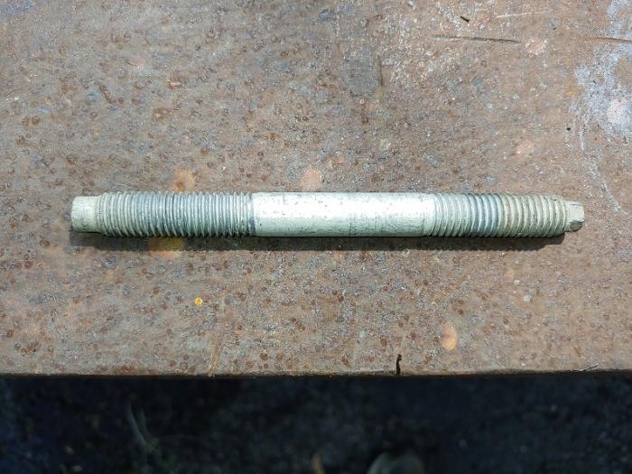

I thought that "stud" was really a through-bolt on Ford's, at least on mine I seem to recall it is. I'll have to check my car.
av8or1
Well, in the case of a Ford Panther (Crown Victoria, Grand Marquis, Towncar, Marauder) the steering rack stud is merely a solid metal rod that has threads on both ends. One end is threaded into the front crossmember. The rack slides onto the stud, covering the non-threaded portion of the stud. Then the nut that secures the rack to the crossmember is threaded on the other end. I'll take a picture today and post it later.
Thanks!
And here is that picture:
steering 120.jpg (69.83 KiB) Viewed 13352 times
There is a hex head visible on the right side of the bolt in this picture. That is 8mm in size and must be the end that faces outward from the crossmember, since it is this hex head that you throw a socket onto in order to install or remove the stud. 'Course there is the possibility that the stud won't wanna leave its home in the crossmember due to rust, etc. and so you can strip this hex head if you use a 1/2" impact to attempt to remove the stud. Ask me how I know. :lol:
