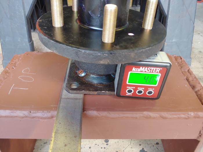

Since the spindle mount of the hubs from Northern Tool were 2" in length, I decided to weld-in another support plate, but this time to the inside of the c-channel. However I didn't put this inner support plate immediately adjacent to (ergo "butt-ed up against") the channel. Instead, I offset it a bit to the inside, thus:
The notion being that it would provide extra stability to the spindle mount, kinda akin to how you put that second hand on the back of the chainsaw. It gives you more control and is much easier to operate than if you only had a single hand on that saw. The astute viewers might notice that the holes in the panels don't quite align. And you'd be right. That was intentional, as I decided to design a positive camber into these wheels from the outset. And that is akin to what you would see on the front suspension of old tractors, thus:

This configuration will allow the gantry to roll better and to steer better. As it would turn out, I went with an almost-5 degree camber:
And with more work, all 4 were welded, put into primer and then painted in burnt orange:
