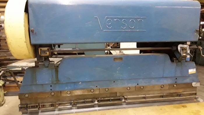

BugHunter
    Sun Apr 19, 2020 12:54 pm
What you did there is pretty cool. When I saw the thread title which said press brake, I figured you meant one like you would find in a Fab shop or similar. I have a Verson press at work which got me to thinking, being this is a welding forum, it's interesting but they actually welded the name Verson into the Press, basically welding the logo into the cast Steel. It's a big Hulk of a machine, 84 in wide. I don't know how many tons but it will take a 3/4 inch square piece of solid aluminum 6 in long and smash it flat so it's a lot of pressure. At first glance you would think it was a bit crude to weld the machine company name on to the machine. But whoever did the welding, obviously with a stick welder, was a magnificent welder. I'll have to post a picture of it if I remember to do so tomorrow. The letters must be 5 or 6 in high.
What year did here to make the dies and saddles for them is pretty cool. I have a similar set up for making c channel out of 4 foot sections of 16 gauge stainless. Very similar to what you're doing here.
BugHunter
Here's a pic of their logo.
BillE.Dee
    Mon Nov 27, 2017 8:53 pm
my daughters boss just picked up a new (to him) brake. I'll have to go have a look see at that one.
BillE.Dee
i received some pics of the brake....don't know HOW to get them in here. This thing is a monster.

BillE.Dee
this is that brake I was talking about. I have NO clue how it got here. Granddaughter did it. Now I have to pay her.
BugHunter
That's a beauty! Nice big one!
