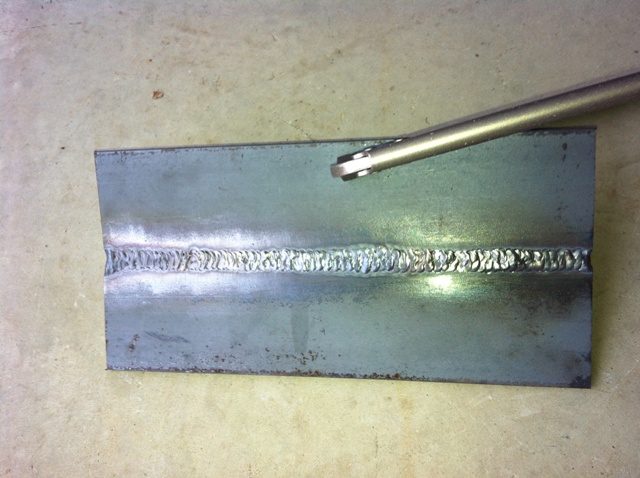

Here is a project I thought I would do just to test my tig welding abilities. I realize this probably means nothing in the grand scheme of things, but I wanted to see how I would perform in a makeshift 3G test.
The perimeters are: (2) 1/4" plates 3" wide by 12" long. They were gapped at 1/4" with a 22.5 degree bevel (or so) with a 1/4" backing strip. I wanted 3/8" plates for the test but 1/4" was all I had at the time so I just went with it.
I welded in the 3G position without repositioning after tacking the backing plate on. I believe I did't put strong enough tacks because the plates bowed quite a bit. As you can see, my weave on the cap isn't real consistent. However, I didn't see any voids or inclusions after cutting the test pieces.
I only took one pic before I cut it. I realize I should have taken more to show all the steps but I forgot.

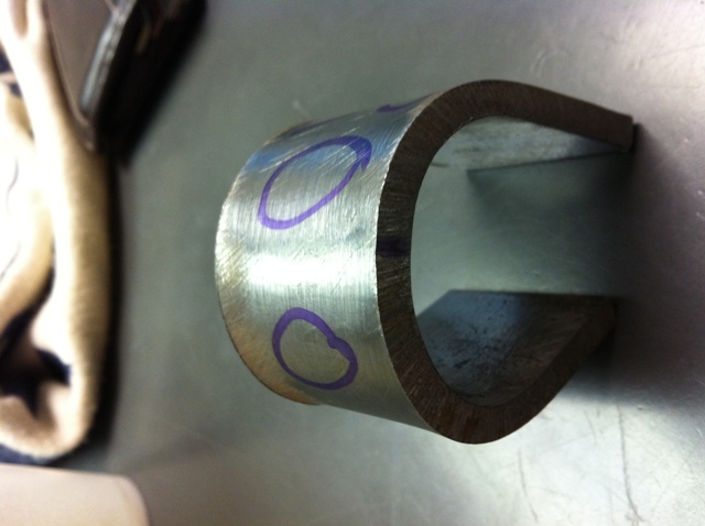

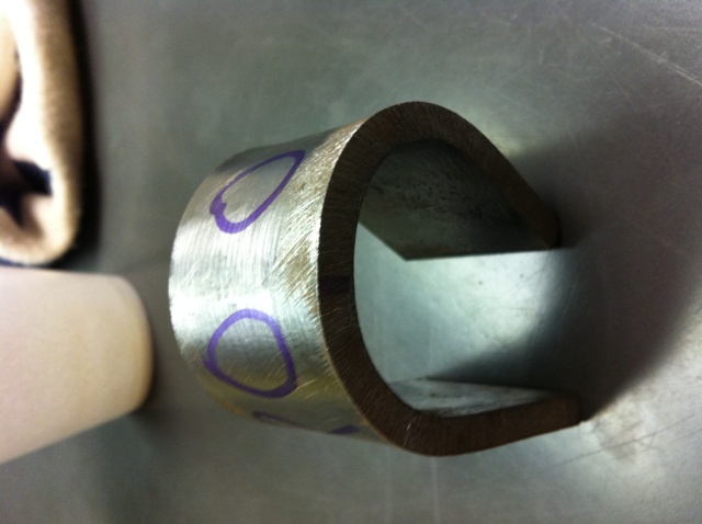

I'm not 100% sure what all of this means, but I thought I would post it anyway. I only have the one test piece bent so far (root). I'll bend to other test piece later. To me, the bend looks pretty good, but I'm basing this on pics of tears and voids I've seen on the internet. Like I said, this may be so far from how it actually is performed that this means absolutely nothing.
I just got the Harbor Freight compact bender and I'm trying to figure out how to use it.

Another way of understanding welding is 'making' weld defects. To alter one welding variable at a time, and see what you find on the bend. For example, at a predetermined location on your weldment, alter the amps and run excessively cold, with the attempt to create lack of fusion. Another example, at another pre-marked location, alter only the gas rate, to attempt porosity. Etc. etc.. See if the bend test reveals any differences.

A plate test with TIG is going to warp some. The thickness doesn't matter. Even if you strongback the hell out of it, you'll get some warping.
TIG on plate isn't a common test, but your methods were sound, and the results speak for themselves. Typically, the inspector will cut four samples from a coupon, and do two each root and face bends. In some applications they'll cut 6 samples and do two side-bends.
These are typical bends for all processes and positions, including pipe.
Let us know how your face-bend comes out.
