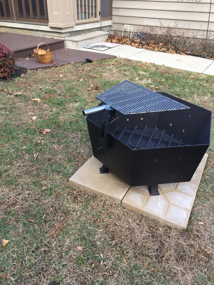

wife asked for a grill for the new fire pit.
made it from stuff around shop.

great job on the grill work.after looking at your design i was thinking of how it would be if you made two grill so you could sandwich the meat in them and just rotate the grill. i have been thinking of making a sandwich type grill for my pit.i leave the lid open on my pit when grilling and just keep flipping the meat over but when i have 60+ chicken wings on it it sorta wears me out flipping them over so they dont burn.

Just don't forget to put something with less thermal conductivity on the handle

have only used it that one time so far. weather hasn't been nice enough
to try cooking on it. cooking grate has 3 height adjustments and i'm
going to add a expanded grate for charcoal soon.

Looks awesome Craig, what are the dimensions of those side panels? We have a old Whalen fire pit that has seen better days, thinking about making something a little more heavy duty than a store bought one.

6 1/2" at bottom, 16 1/2" on top, 13 1/2" vertical height. 11 ga sides 1/8" bottom
