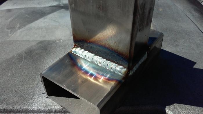

Trying to get the mig to look like tig. This is one continuous motion, no start and stops. Pull to the right fairly quickly, then slow down a bit for the e loop and repeat. Any comments or suggestions? Thanks, John.

John, looks pretty damn good!
What were your settings?

Thanks Rick. I just turned the wire feed speed down until it sounded bad and then slowly increased it until you get the first crisp sound of bacon fryin. -e-e-e-e pattern dragin from left to right. John

that looks really good. I've been out of town working for a friend and just got back last night. I really want to try mig like tig and see what I can do.Hollywood1 wrote:Trying to get the mig to look like tig. This is one continuous motion, no start and stops. Pull to the right fairly quickly, then slow down a bit for the e loop and repeat. Any comments or suggestions? Thanks, John.
