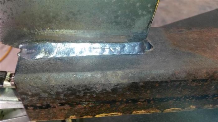

Hello all. I've been welding about 12 years with most of it being solid MIG with shield gas. I've gotten set up to do flux with gas on a couple of machines (MM 252) using Lincoln wire for 75/25 per reading their Web site.
I'm pretty happy with the process but I get worm trails in some of my welds randomly. I need to learn more about how to use this process. I didn't find a section on it at WTT.com. tried searching here but got overloaded with posts regarding plain flux core welding. Can someone point me in the right direction for some beginners information regarding this process, please?

There are a few things that can contribute to your "worm track" problem. Some of them are to much voltage and moisture either in your wire or plate/air. Personal experience has been to much gas flow, therefore the puddle will solidify before the gas can escape. I was building a platform and was getting worm tracks, lowered my cfh and fixed my problem.

Pushing (standard 15' gun on the 252, 0.045 wire, and I changed the liner to the 0.035/0.045). Not able to provide a picture at this time; I'm not at my shop and I've moved (sold) or repaired all my problem parts at this time. :-/
I don't like buying anything red but I don't know of any better brand of filler metal. I'm all ears but I'm pretty sure there's only a handful of factories that actually make this stuff so I'm not confident that one brand would be any better than another; they may be the same with no way for me to know.

Switch to dragging and you should be golden.

I'm using the weld chart on the MM 252 for the voltage and wire feed speed for the given thickness of base material; not saying it's not a voltage problem, just saying what I'm doing. I use a twist of old welding lead under the ground clamp to improve my ground (a tip from WTT.com), FWIW, so I'm confident I'm getting good ground (current and voltage being related).
I started this thread mostly with the idea that this all may have been covered elsewhere and a desire not to be rude and duplicate effort. To that end I limited my information. Let me flesh it out a bit:
I converted my MM 252 from solid 0.035 to flux/gas 0.045 (including the drive wheels to groove and the liner to the 0.035/0.045). New wire, right out of the box, selected for the shield gas I had, per the Lincoln website. Welding on mild steel from 10 ga to 1/4" so far. I'm using the weld chart on the machine to select the settings for voltage and wire feed speed. I started out with the Weld Aid lube pads and the welding was great for the first few small welds then went to crap (worm tracks and porosity). I took the lube pad off and, after burning through some wire a bit, the welds came out great like at first (same scrap metal, same condition). I figured the lube was a problem so I took it that I could not use the lube (new lube pad, and I did not add any additional lube to it).
I bought a second MM 252 because I wanted two machines set up for this process for larger projects where having a machine on each side would allow me to save time (I've gotten spoiled on building smoker trailers with two machines). Brand new machine (my first MM 252 is about a year old), brand new wire right out of the box, drive rollers, new liner (to replace the factory one with the larger diameter liner). Still got some voids on my first weld.
I've tried the Radnor anti-spatter spray (the BB's from the flux/gas shielding are industrial when they stick; larger and harder to remove than solid wire with 75/25). I've tried the Weld-Aid spray anti-spatter (some red liquid in a gallon jug sprayed with a common spray bottle), and I've tried no anti-spatter. The metal is clean with a small amount of what I call flash rust; it's not flakey or crusty. I've tried power wire brushing the metal before welding.
Today, after writing my initial post, I was doing some flux/gas on some smoker trailers I'm building and decided to turn the wire speed down because I was getting a lot of BB's. That seems to have greatly reduced my worm tracks. I only saw about 2 to 3 defects on four pieces with two weld areas on each totaling 16.5 inches each. It was improved.
But I'd still like to learn more about the process. MIG can be finicky. Too much rust, paint, oil, things I can stick with a 6010 5P+ with no problems can look like Fido's butt (to borrow a term from WTT.com). But what I'm welding with here I've had no problems with, using the standard ER70S-6 (if I'm recalling the letters correctly), 0.035 and 75/25. I've learned over more than a decade of doing this (as a hobby business, to be honest; it's not like I weld every day). I'm hoping there's something simple or stupid or both I'm doing wrong.
I will try to lower the CFH (I'm indoors but I usually have the doors open, closing one or more doors if the wind is too bad). I seem to recall that I set that, too, by the chart. But I'll not ignore a possible solution. And there is the consideration that the weld chart may be for the "standard" flux/gas wire which uses 100% CO, I think I recall. I will check this, too.

Flux -Cored wirwe, or duel shield, should be dragged in my opinion, you have to keep the slag out of the puddle.
Try pulling and get us a pic,

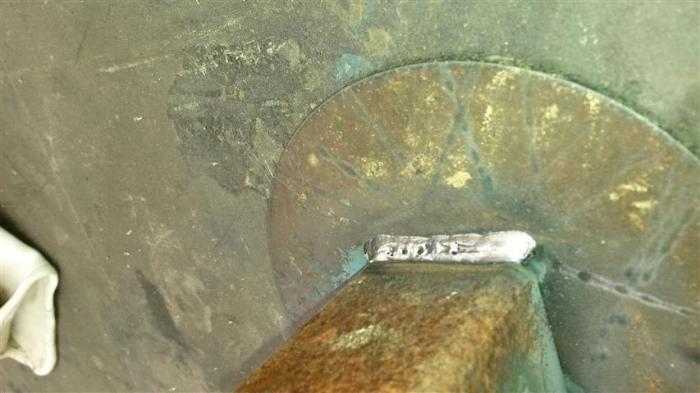

First, I welded a number of items from mildly rusted to pretty bad (not flakey). I pushed and pulled. I used Radnor ant-spatter spray in the white cans (not the green cans which is water based), and I used WeldAid 350, I think it's called which may be water based. I applied light and heavy. I did the same type of parts (smokers and some stands I built to set them on) with each of the variations. I turned the gas down. I adjusted stickout.
Here's the bottom line: the greatest thing I did to reduce and almost eliminate worms and pitting was to pull back and increase stick out (per the helpful link to Lincoln's site on the topic). The WeldAid anti spatter is a no-no. Bad pitting. Presumably water based. Pulling seemed to be a good thing to do until it occurred to me that I was doing it as the second pass on a part after the first pass was done on the other side of a 3/16" piece of metal (fillet). I got worms and pitting on the first, forehand pass, and no worms or pitting on the backhand pass. However, when I changed to doing the backhand pass as the first pass and the second pass forehand then I got bad worms in each of my backhand passes, four in total in a row. Both passes were done at, essentially, the same time; weld one side (3" bead) then immediately switch to the other side and do it. I think the first pass cooked off moisture and other contaminants so the defect-free backhand welding was misleading.
A bad backhand first pass:

- Forehand minor defect.jpg (38.33 KiB) Viewed 1950 times
- Bad weld.jpg (38.22 KiB) Viewed 1950 times

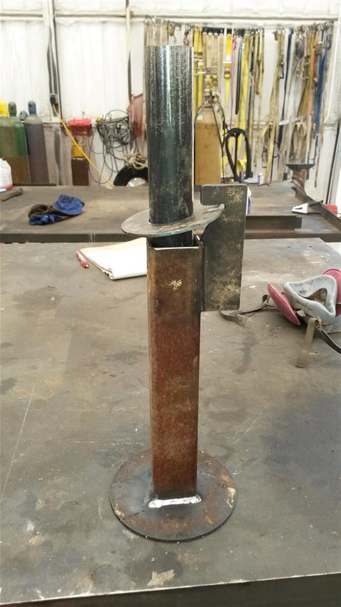

I am building some smoker trailers, as I've mentioned, and leveling them for the build has always been a PITA. So I finally had a vision of what to do: make some slip-lock stands to support them. Level them with some cheesy travel trailer levelers then place these quick-set puppies under there. I had a stack of old plow discs laying around and a plasma table with plenty of Z axis travel and THC. Viola! Pretty darned good, if I do say so myself.
Oh, I used the plow discs because they're curved. I knew if I welded a piece of tubing to the center of a flat disc the weld warp would pull it up and it'd be like a mushroom upside down. Just in case you're wondering why I used what I used.
