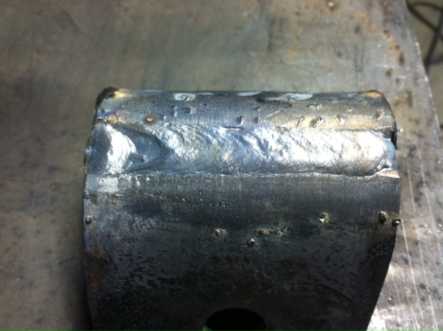

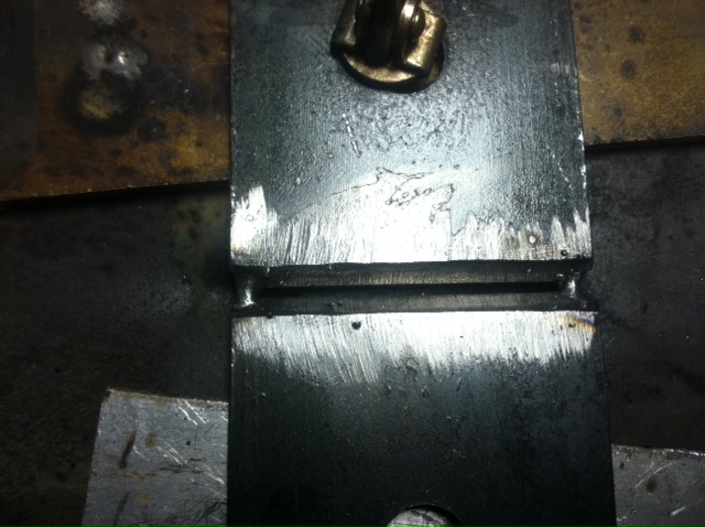

Well curiosity has got the better of me...I went in the basement and found the self-shield flux core, changed gas to C-25 and welded 1/4" test samples with it in the 1G position, 3/32 gap, no backing bar. Remember this wire has been open for over 2 years and my basement is not the driest in the world. I did the hammer test on one plate and it held up fine. The second sample I will bend in the morning and post pictures.
    Thu Jan 24, 2013 10:13 pm
    Eddy, TX
Here you go.
First specs. Wire Harris Ten Gauge mild steel self shielding .035. Wire speed 400, 23.5 volts. Gas C25, 25 cfh.
I grabbed a couple pieces of 1/4" plate and beveled them with a 1/16" land, 3/32 gap. Single pass, I got full penetration of approx. 3/32 ish. I am only doing this to see if it would break on a hammer test. I bent two sets of samples and neither one showed any signs of cracking at all. Remember this wire has been out for at least 2 years and has rust starting to form on the outer layer of spool.
NOTE: I was not trying to lay down a pretty bead nor necessarily following testing rules. I was just curious.

so what did you conclude???
did you also run a bead with just the straight wire, no gas???
Opinion of the time you spent on my theory????
John
    Eddy, TX
I did run a bead with no gas and it ran fine. It seemed to look hotter with the gas but I don't know. I did run beads side by side and noticed no huge difference in welds. It seemed that with gas the slag was blown away from the weld puddle while welding. The gas weld was a little wider but not by much. It could also be that my travel speed changed between welds. As for a final conclusion I still say there is a place for "bad" wire, but it is does not belong on something that would be critical or support life on it. How would you or I feel if our weld failed because we thought it was fine and it wasn't? I guess one thing to remember is most hobbyist welders that are using self shield wire probably have it on their machine out in the open for quite a long time and never give it a thought. I know someone who has a machine set up in his garage with self shield and I know for a fact it has been at least 6 years since he put it on. He does not use this machine very often and probably never gives it a thought when he used it.

As far as my opinion of the time I spent on your theory, I would not say it was a waste at all. I learned something. Although swinging the sledge hammer was kind of a pain in the butt!
I had absolutely no porosity in my gasless welds but that is not to say someone else wouldn't as well.
I would find it interesting for someone else to perform a similar test and see what they come up with.
