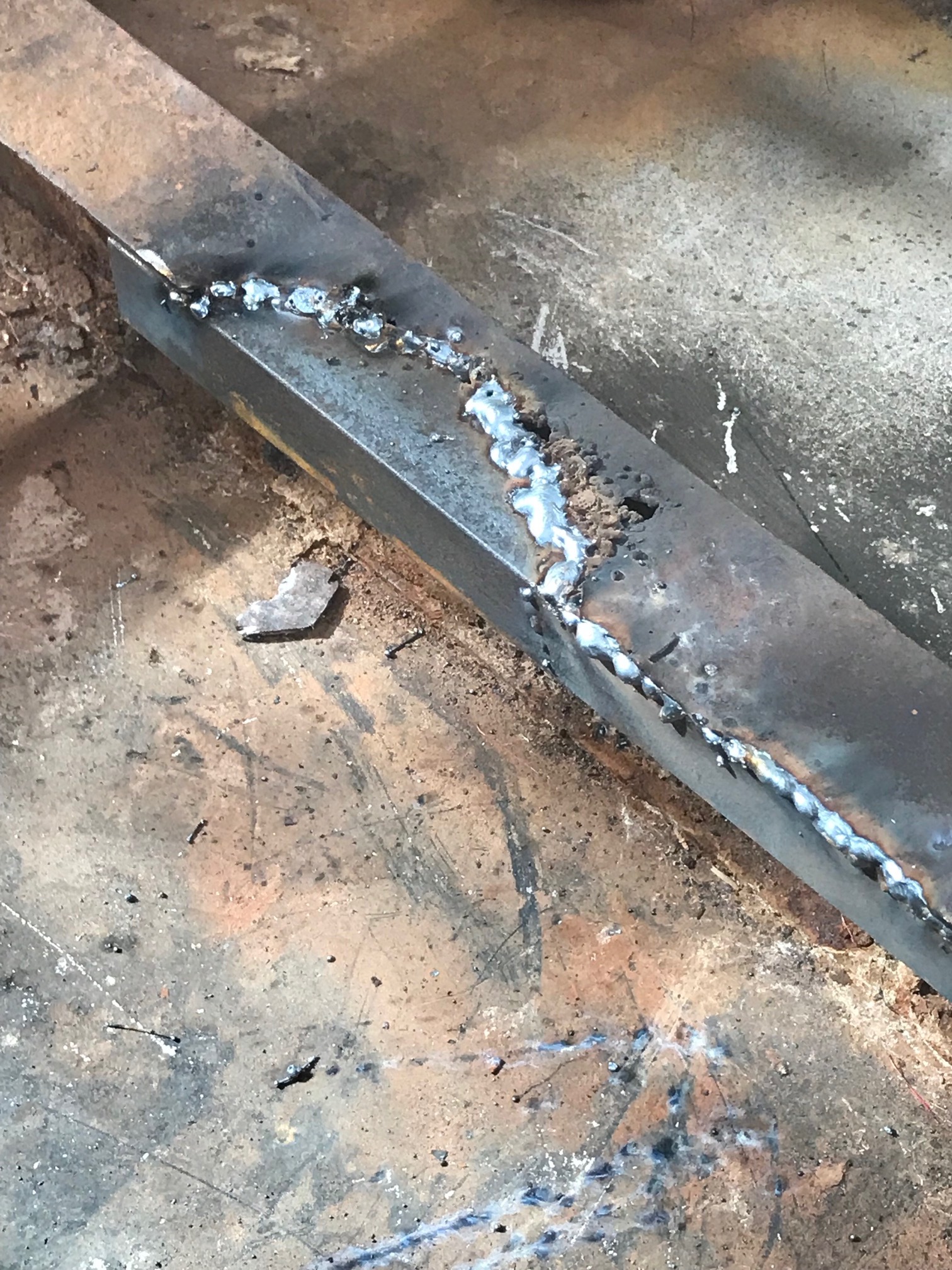

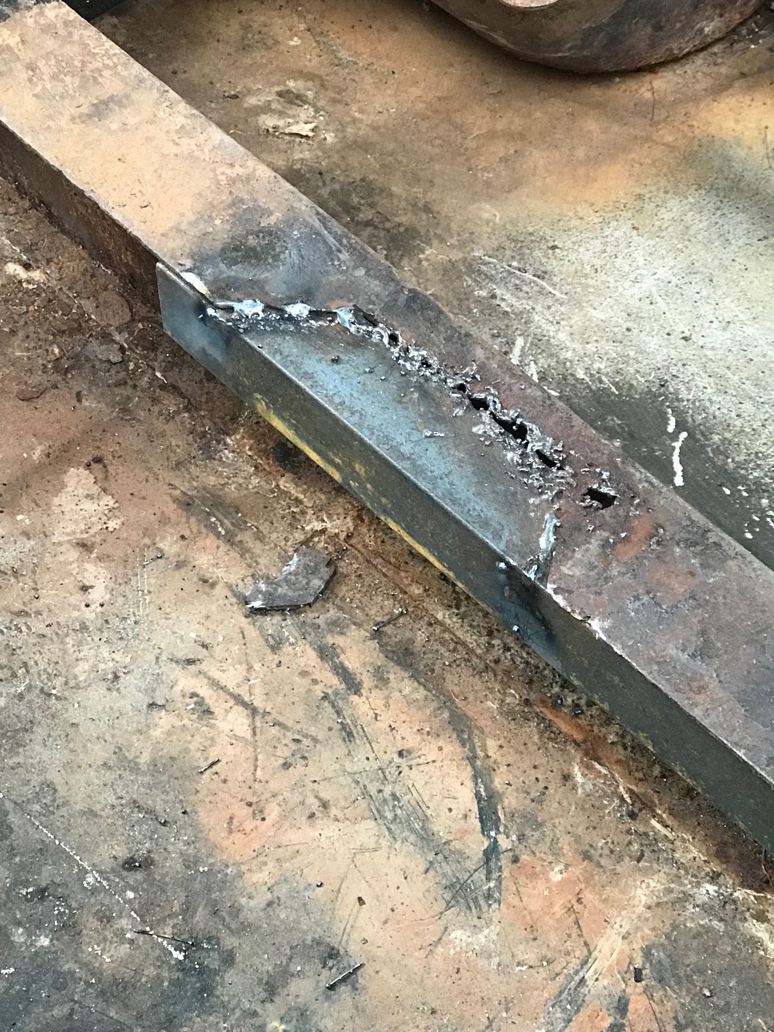

Hi Tweake, All,
Another attempt this morning. As posted on Welding Talk, here are a few pics. I tried to slow down, at least some... 1/8" steel Airstream frame cross member. Settings on the Harbor Freight welder were Max 1, 8.5 wire speed, using .030 solid wire and 75/25 "Gold Gas"...
Two pics... first is with no experience and little absorbed advice. Second, after getting answers on these forums and watching more videos...
Thanks,
David

first thing is clean the metal. get the grinder out and get some nice shiny metal to weld.
just run beads, just like in the videos.
i would go get a stick welder.
need to learn how to form a puddle and move that puddle, and not have a ton of adjustments you need to get right.
one thing that often happens with mig is people learn the settings and weld with there eyes closed. that can work but it obviously can bite you in the rear end.
stick forces you to weld with your eyes open. learning stick makes learning mig a whole lot easier because your eyes know what to look for.
don't worry it doesn't take to long to learn stick.

thats even better, you will learn it in no time.
jody also has a lot of good video's on it. binge watch them until your eyes bleed lol.
once you know what to look for, you can see it and make it happen, you will be fine.
a days instruction and you will have the basics down. then after that going to mig is much easier.
don't forget nothing wrong with stick welding a trailer, often preferred if your outside.
