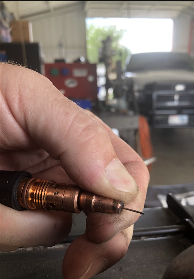

I need some wisdom. I bought a TWECO 211i right after they switched the name from Thermal Arc, so it's been a few years. I've struggled with the mig function on this machine since I got it. So I have mostly used it for smaw if any real welding needed to be done.
The starts are the problem. It is just horrible. Sputtering, popping and burning the wire off into the tip, not starting the arc, or cold starts (and porosity) for a second or two and then it takes off and welds ok. So I've replaced the ground clamp, upgraded the ground cable, changed wires, tips, checked the gas flow, checked the liner (which hasn't been used much), tried increasing wire speed and voltage way higher than what should be needed. I've become anal about keeping my ground as close as possible and clamp on bright bare metal, and the problem persists. It acts like a bad ground or bad connection closing the circuit.

I did more checking today. I tried to get a picture of how the wire has to cross the reel to get into the guide. I dont think that helps. The wire reel has a hole that a pin sits in to secure it to the tension hub...
Then I took a close look at the gun and found that I could not push on the the tip hard enough to compress the liner for the tip to contact the diffuser. I know its supposed to be a little long so that the nozzle compresses it, but I don't think it's seating fully. So I'm thinking the liner is too long and may be the source of the trouble.
After looking at it more, I don't think I like this style of contact tip that just sits on there, or the large diameter of the nozzle. I'd prefer a screw-in style and smaller diameter tapered nozzle. I found an HTP gun that should be plug-n-play for $120.

- IMG_1638.JPG (34.82 KiB) Viewed 3647 times
- IMG_E1642.JPG (463.95 KiB) Viewed 3647 times
- IMG_1640.JPG (38.59 KiB) Viewed 3647 times
- IMG_1639.JPG (34.75 KiB) Viewed 3647 times
