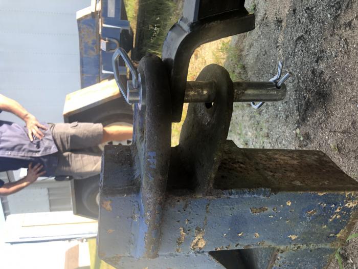

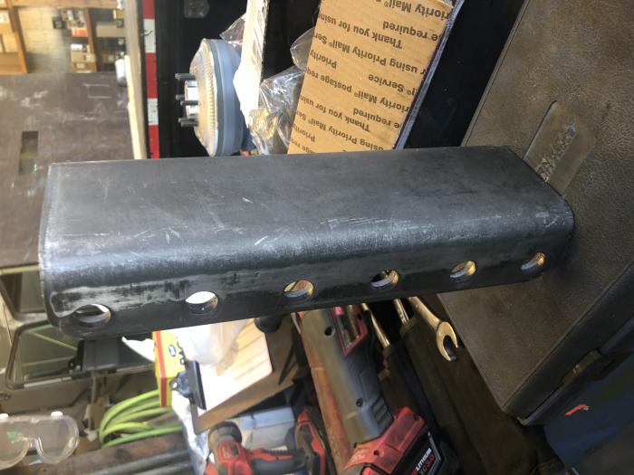

Hey guys, new here. I have to cut off the piece of the trailer where the hitch connects to, then weld a plate which allows for adjustable height, I will have to weld vertical uphill with 0.35 wire with a Lincoln Electric PowerMig 256. The plate being welded to the trailer is 3/8 in thick, the trailer part is a solid piece of steel, 3/3.5 inches thick width wise. I need recommendations on wire speed and voltage for this application, and wether or not I should use the upside down v weave method to weld uphill. Please help! I will attach a few pictures below. Thanks for your time!
- Plate going on the front after excess steel is cut off

- Part of trailer where I have to torch the existing off the front for a flat surface to mount the plate

Can't say I've ever welded anything like that, but I'm curious to see the replies. For vertical uphill, Jody says uphill is a "must" using the inverted-V so you can have the arc get the required penetration at the root ahead of the puddle.

I also will be welding on a similar hitch channel using 0.35 GMAW-G. Is there any technique required different than hard wire like Jody's video? The mounting plate is 6" wide X 3/8" thick. I don't have the hitch yet (7000#) to see how thick the channel is. I can pre-heat the plate. Thinking a hot root pass in the V of the formed channel and 2 cover passes? Not real proficient on vertical uphill yet but cut and etch on some practice pieces are not too bad for penetration. Welder is 250 amp.ZacCarter96 wrote:Hey guys, new here. I have to cut off the piece of the trailer where the hitch connects to, then weld a plate which allows for adjustable height, I will have to weld vertical uphill with 0.35 wire with a Lincoln Electric PowerMig 256. The plate being welded to the trailer is 3/8 in thick, the trailer part is a solid piece of steel, 3/3.5 inches thick width wise. I need recommendations on wire speed and voltage for this application, and wether or not I should use the upside down v weave method to weld uphill. Please help! I will attach a few pictures below. Thanks for your time!
