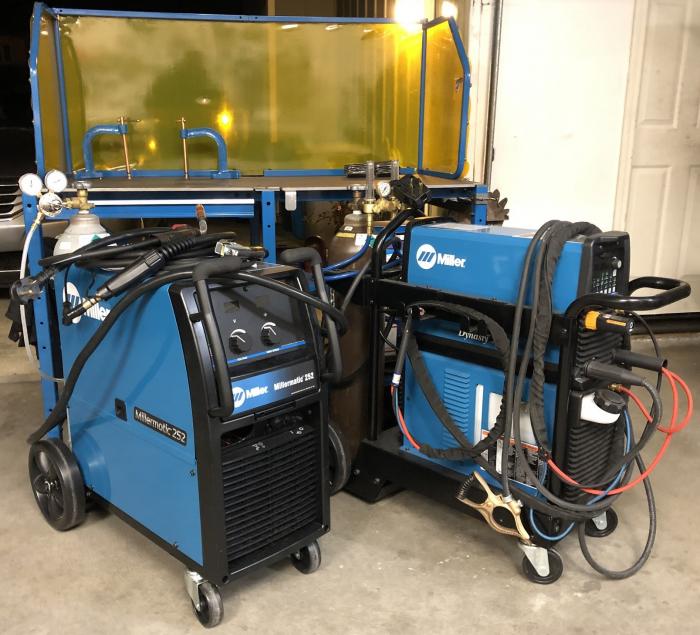

So here is the welder for which I started the thread. I pictured it next to my Dynasty because I love it when things match.

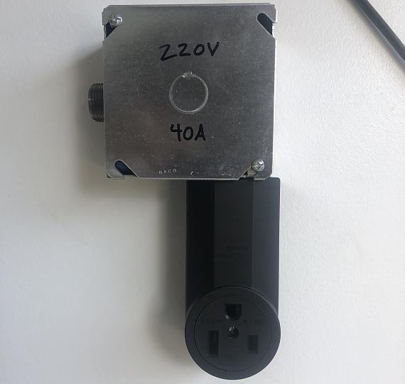

I noticed that the Millermatic has a 3-prong 220V plug as opposed to the 4-prong of my Dynasty. Is this because the Millermatic is a transformer based machine as opposed to the inverter Dynasty?
I bought a Q sized cylinder of C25. I installed a 3-prong 220V outlet (using a 40A breaker and 8 gauge wire--I hope that's okay!), but I ran out of money before I could buy ER70S-6.
I am going to sell the Hobart E71T-11 flux-cored wire that came with the machine. Like I said, the main reason that I bought this welder was to learn to weld like we do at work, and my boss always uses solid core and C25.

3 prong is for single phases power, 4 prong is required to run 3 phase power. Has nothing to do with inverter or transformer. Your Dynasty is autosensing for the inbound power and will run 120v-480v, single or 3 phase. The MillerMatic is restricted to 240v single phase I believe.

That is really helpful. We got the two 220V outlets wired up in the new shop. I need to rent a truck to get the Millermatic 252 over there.cj737 wrote:3 prong is for single phases power, 4 prong is required to run 3 phase power. Has nothing to do with inverter or transformer. Your Dynasty is autosensing for the inbound power and will run 120v-480v, single or 3 phase. The MillerMatic is restricted to 240v single phase I believe.
