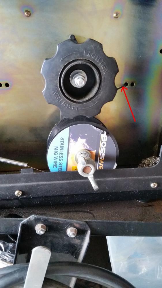

Hi,

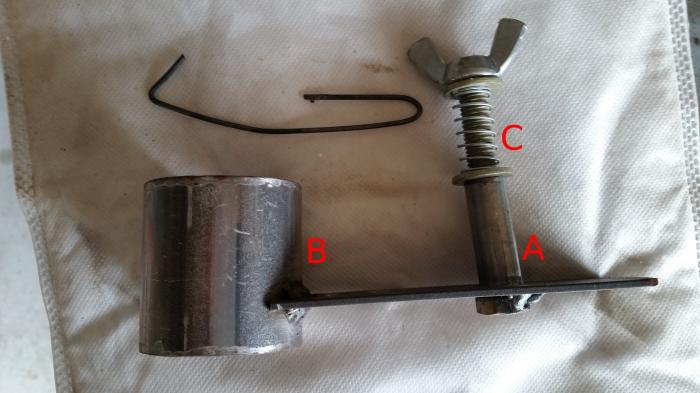

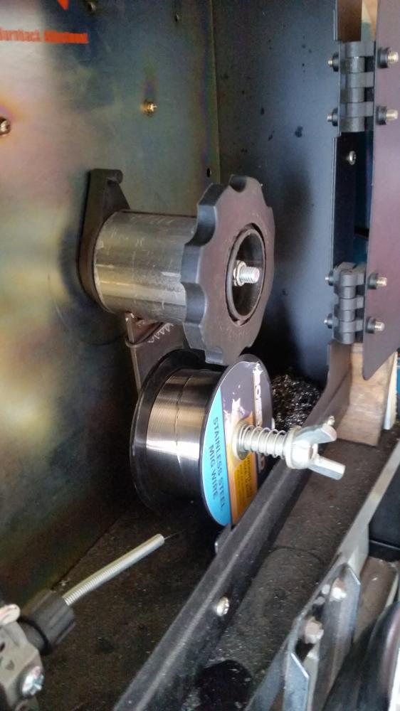

I have one of those MIGS which takes the bigger 5kg reels but has no built in adapter for the small reels and I had a small job to do in Stainless which I usually do with TIG but this is a painful and awkward job so I wanted to try SS MIG but didn't want to buy a 5kg roll of SS. So I made the above one out of scraps of plate, some small pipe the same external as the inside of the small reels (A), some exhaust pipe the same as the external of the big roller (B) and a bolt with some washers etc (C).
Note I also use a wire clip to hold the roller back away from the feed mechanism (arrow in pic below).
As u can see from the pic it works just fine "-)
