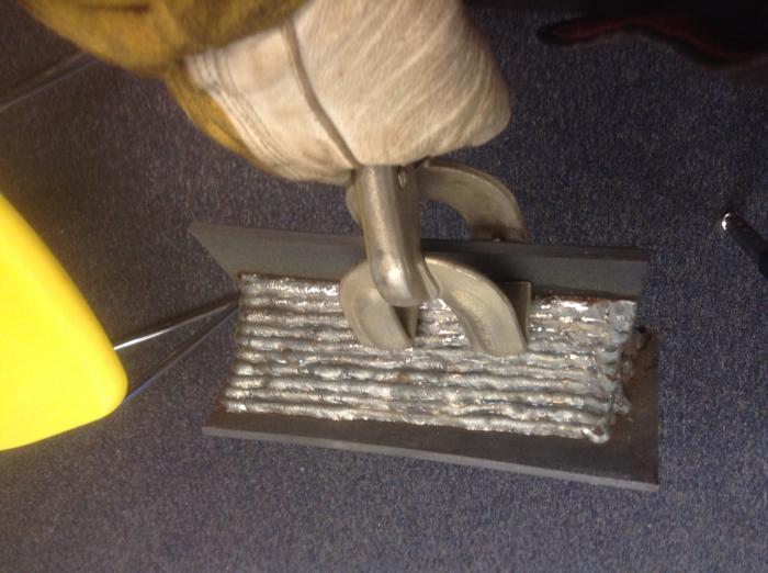

I got bored today so I welded the crap out of some 1/4" plate in a t-joint. Took 2 hours welding and cooling. 55 passes and 2.5 miles of wire at around 18.4 volts and around 260 ipm. Good practice stacking beads and to get better at reason and watching the puddle. As you can see, one side was favored more than the other which I am thinking had something to do with by the time I got to the top of the joint it was hot as hell so it sunk deep into the metal and other welds.

Between the individual beads, little to none. Every time I finished a layer though I dunked it for awhile. That kept the heat under control pretty wellshady wrote:How long did you let it cool between beads?
