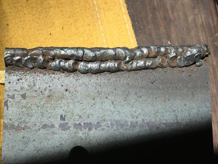

I'm running my first practice beads on 3/8" by 3" hot rolled steel bar. After running a few of these, and trying to get the Miller 140 autoset welder dialed in (amperage and wire feed speed), I have sliced across the work so far. I was chagrined to find no evidence of penetration.
I am using 75/25 gas mix, .030 wire. I cleaned up the surface prior to each bead.
Am I reading this situation correctly? Photos attached. I will continue to try different combinations of settings, but I had hoped to find at least some evidence of penetration here.
I know that the most basic problem here is that I am attempting welds on material that is outside the specs of this welder, but I was hoping that with good technique and settings, I would be able to compensate for at least some of the shortfalls of an underpowered system.
- IMG_4878.JPG (34.3 KiB) Viewed 5008 times
- IMG_4882.JPG (46.99 KiB) Viewed 5008 times

If the base metal is too thick, you'll never get the penetration needed. If your machine is limited on its capacity,you can preheat the base to aide in penetration. But your issue is more than just too little current, you have some technique errors as well.
Your travel speed is too fast.
Your arc length is probably too long as well.
Your metal doesn't cleaned up at all either. It needs to be bright shiny metal with MIG.

Thanks CJ.
Is the arc length primarily decided by how far your nozzle tip is from the welding surface? Most of the time, I felt that I had it about as close as it could possibly be. I will try some subsequent runs of bead with slower travel speed.
I am still not getting a good look at the puddle as it is being formed. I think this might be a factor that is leading me to run the weld a bit 'blind'. I have my helmet set at 8 (lightest setting) and have also put in an optical 2 x piece.

Arc length is officially the distance from the end of the contact tip to the base metal. Generally for short circuit mig I use 3/8-1/2¨AussieWelder wrote:Thanks CJ.

Respectfully, I disagree.Farmwelding wrote: Arc length is officially the distance from the end of the contact tip to the base metal. Generally for short circuit mig I use 3/8-1/2¨
That's CTWD: contact tip to work distance, people also call it stick out.
Arc length is something different, for example with stick welding or spray transfer - then you have an arc length.
From Miller:
"Wire Stick-out
Stick-out is the length of unmelted electrode extending from the tip of the contact tube, and it does not include arc length. Generally, maintain a stick-out of 3/8 in. and listen for that "sizzling bacon" sound. If the arc sounds irregular, one culprit could be that your stick-out is too long, which is an extremely common error."
Lincoln, more in depth: http://www.lincolnelectric.com/en-us/su ... -ctwd.aspx

Also, how is your gun angle? It shouldn't be more than a few degrees off of 90, but a lot of new to mig guys will end up tilting the gun way over to kind of see what is going on. That just stacks the metal upon itself with virtually no penetration/fusion. This also messes up the contact tip to work distance.

You say you're cleaning the material each pass. I see no evidence the material is anywhere near clean. Define "cleaning" as you are using it.AussieWelder wrote:IMG_4881.JPGHello everyone,

That metal should be bright and shiny before you call it clean. Every bit of that (green?) crap should be gone. It seems to appear in the line of "no penetration" in your cut section. Use a grinder with a hard stone, and make some sparks until the metal is silver in color. Until that is done, there's no use working on settings.

Speculating about machine settings and gas flow id all fine and good, once he's welding on CLEAN, SHINY metal, not that green crusty crap in the pictures he shared. I'm serious, study the picture where he cut the "weld", and you'll see that crust continues uninterrupted under the beads he set on top of it.

His welds look really cold despite the (lack of) prep. These attributes are being observed/commented on. But once his beads get/look better, an analysis of penetration will also reveal inclusion of the mill scale that needs to be removed. Walk before you run...
I did. That's why I figured the gun was laid way down. Its incontrovertible that the prep is bad, but then there's also the caterpillar like bead. Easy enough to assume settings due to the lapping, but if you draw a line perpendicular to the eye (or where the weld was stopped/restarted) it appears to be way off from any typical position. Even if the settings were in the "close enough" range, this will result in no penetration/malformed beads.Otto Nobedder wrote:Who actually studied the pictures?

...but if you start with clean, uncontaminated metal, all the other s#!t you're talking about can be gauged and adjusted. You have no idea what that green crust is, or what effect it's having on this weld. I've never seen mill scale look like that.

Show me what your settings do on clean metal, and I might be able to tell you something. The unknown crap on the steel is a variable I can't (and these other bright people shouldn't try to) account for in any suggestion I or we might give you.

Quite true, but with .030 wire, it's doable (preheat is advisable). There should be some measurable penetration in this attempt, even if it's only near the toes and doesn't close the root.AKmud wrote:3/8" is pretty thick for that small of machine. Once you get it clean and shiny, hit it with a torch to pre-heat. Your machine is struggling.
Before I make any attempt at advice, I want to see an attempt on metal that has been ground until there's no chance of whatever that green crap is to exist in the tiniest pinhole.

#1. Forget using a 110 welder on 3/8 steel. Period.
#2. Forget using a 110 welder on 3/8 steel. Period.
#3. Go get some 1/8 steel.Leave your machine maxed out. Go weld some 1/8 steel.
Penetrated purty good didnit ?
Ever took a look inside the door on that machine Aussie ? See anything about 3/8 steel ?

But,,,,even though he won't be able to make a 3/8 bead capable of welding 3/8 in a single pass. He should be just fine welding a bead big enough for 1/8 steel on a 3/8 plate. It won't just stop working because the plates too thick. If he's on good clean steel and gets the machine dialed in then the resulting weld will have good wet in on the edges. Regardless of how thick the base plate is!
